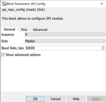

I would like to use NVM chip (M95M01-DWMN3TP/K) on DVCU5775EVM, so initially I have prepared simple model just to check chip status.
Chip is connected to SPI0 with CS1
And I have used these settings for SPI blocks

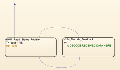

Then have prepared stateflow diagram to send control commands
where Tx_data is control command (RDSR) from M95M01 datasheet
and this command goes after chip is selected
Finally I have got following model.

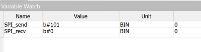

After flashing, I have used Freemaster to check SPI feedback signal from NVM and it is always 0xff.

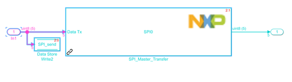

I had a look at your model and attached the model with a couple of changes. I don't have access to your board and I cannot test it, but I had a look at the signals using the logic analyzer. See the image attached below.
1.  SPI settings - for that you can select the CS pin in the SPI_Config, you don't need to change it by hand. To select the device you can select the CS in the Master transmit block, the one you have already used.
2. In the Stateflow, you can remove the chip select state, because the DSPI will handle that, so you can only send and decode the responses from the SPI.

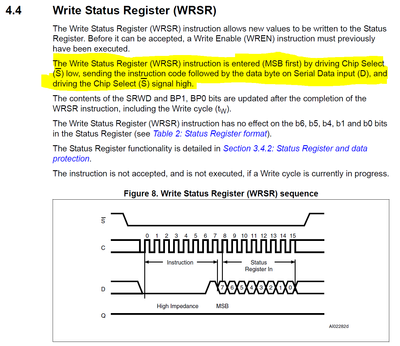

As per datasheet, we need to keep Chip select low while sending command and getting data from chip
Your image shows that Chip Select goes High after transmitting of command, am I right?
Is it possible to keep this signal Low until we will get data?

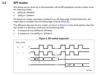

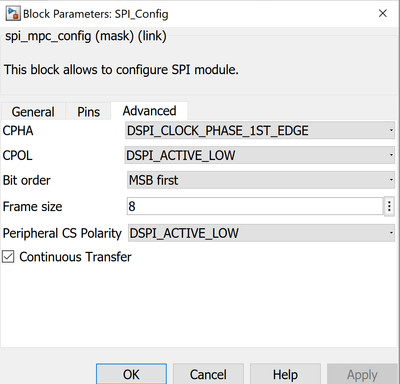

Another question, these SPI settings are correct
to provide one of following SPI modes?
Also, to send 8 bits command and 24 bits address I need to change SPI frame size to 32, am I right? Then how to change this frame size dynamically? For example to Read Status Register it is required only 8 bits, to Read data 8 bits for command + 24 bits for address, to Write data 8 bits for command + 24 bits for address + Data.
Input and Output ports have same size, so does it mean that we can only send/get SPI frames with same size?

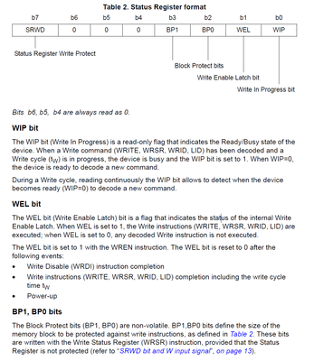

I have changed SPI frame size from 8 to 16 bits, assuming that Chip select will be Low enough time to read feedback (8 bits) from NVM chip.
Now my SPI receive data is 0.
It looks fine for Read Status Register command, because bits 0,1,2,3,7 should not be set by default.

You can send variable bytes number (8, 16, 24, 32, 40 ...) with a continuous CS by selecting the Continuous transfer. But I've seen that you have already done that.
So, you select the frame size as 8, and you populate an array with the commands you want to send. F4irst byte is the command, then the next 3 bytes are the address. If you provide such an array to the SPI Send block, this will output on bus 4 continuous bytes, with only one chip select transition.
