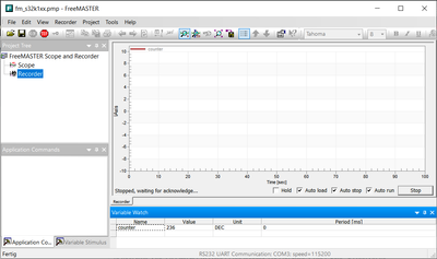

I want to look at some variables in a very high frequency (see Fig. 46 in https://community.nxp.com/t5/Model-Based-Design-Toolbox-MBDT/Module-6-Current-Sensing-Part-2-2/m-p/7...). I have an MCSXTE2BK142.
From my understanding a scope is too slow for this job. Due to this I have to use the recoder. When I flash the FreeMaster Recorder example of the MBDT in Simulink to the Board (Project fm_s32k1xx), which demonstrates the FreeMaster Recorder Functionality, I get no values. This is the example where I changed the Targed Block and the FreeMaster Config for MCSXTE2BK142 (see attachment):
After some seconds in the FreeMaster scrren, there is the error "Stopped, waiting for acknowledge":
How can I use the recorder function? Is there a mistake in my configuration?
Furthermore I do not understand the placing of the "FreeMaster Recoder Call" Block in Simulink. Where do I have to place the block so that it works?

I have the very same problem, hope some NXP expert solve this.
