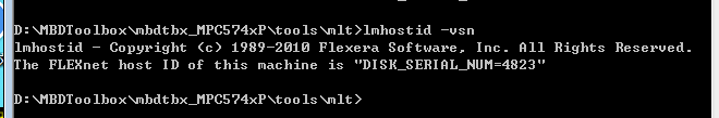

   When I click on the run prompt “Undefined function or variable 'lic_err' ”, I used 5744MBD,My license are already registered on the website. I am using the DOS Command mode.Can you help me Solve this problem?

Daniel_Popa
Can you please attache here (Use Advance editor to show the attach button) the license file and the screen capture with the Window CMD console after you have typed: vol c: command (or whatever partition you used to install the the toolbox on)
Thank you!

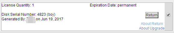

释然111
license.dat
#Motor Control Toolbox for MATLAB/Simulink MBD - Model Based Design Toolbox
#for MATLAB/Simulink MBD supporting MPC574xP for ? ? Software Account
# License for DISK_SERIAL_NUM=4823 boy
INCREMENT MC_Toolbox_574xP freescale 1.0 permanent uncounted \
VENDOR_STRING="Model Based Design Toolbox for MATLAB/Simulink \
MBD supporting MPC574xP" HOSTID=DISK_SERIAL_NUM=4823 \
ISSUER="Freescale Semiconductor" ISSUED=19-jun-2017 ck=205 \
SN="FSL - 20103187" TS_OK SIGN="1741 D00E E5A3 3705 537E ACBA \
3179 06B4 4947 08F1 AE1A 6B46 FB9E F6ED 395B 1450 BC0D CAAC \
3605 58E1 BC7D 6B97 5CCA 1336 7786 BC39 4EC2 1181 7876 08FE"
5,441 Views
Daniel_Popa
It looks like you are in this kind of situation: https://community.nxp.com/thread/451913
since we have a Disk ID with  only 4 numbers.
We will prepare a patch to fix it and send it to you ASAP.
Thank you!

释然111
thank you very much, it can be used normally!
