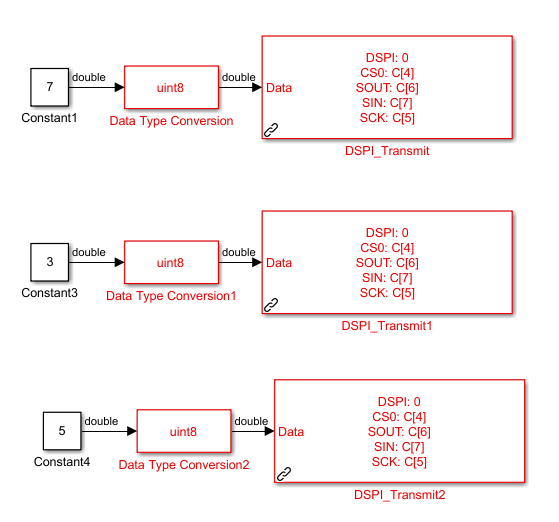

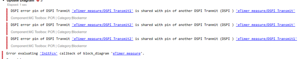

Hi Daniel,
    To read from the EEPROM,it's necessary to send several SPI instructions continuously during a  interrupt.
     I try configure as follows,but there're some errors.
Is there any other way to send several SPI instructions continuously at a time to avoid the errors above?

vsingh_iitkgp
I would suggest to use Repeating sequence stair block if you need to transfer more than 2 SPI data transfer. Use different values of repeating stair case signal values as different switch case

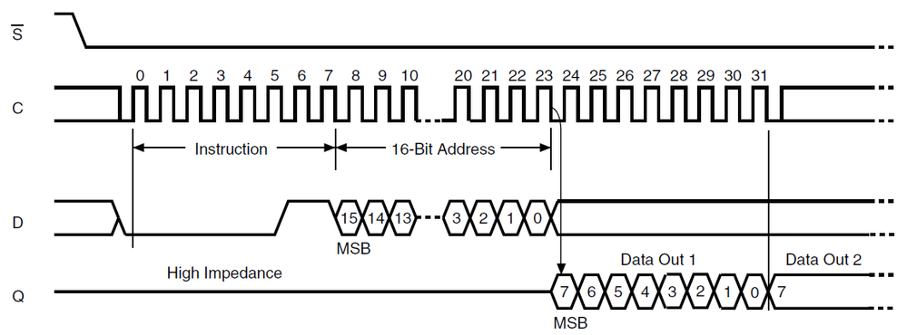

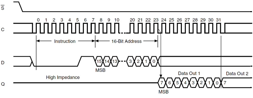

Hi Daniel,
     As shown below, to send the instruction to the device,it must remain selected between several sequential serial transfers.
      Though trying it many times,all I can configure is as follows,in which the device is not selected continuously.Can you show me the way to cofigure the Continuous selection format?

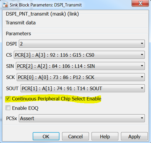

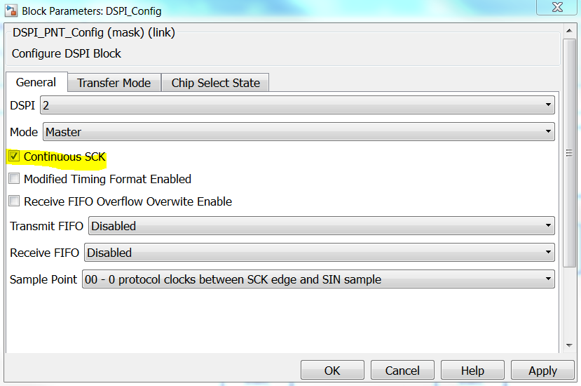

Daniel_Popa
Hi hjhjhj‌,
In this case you need to activate the Continuous Serial Communication Clock and Continuous Peripheral Chip Select Enable:
That should do the trick. Please let me know if you managed to make it work.

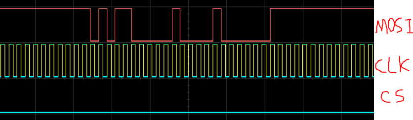

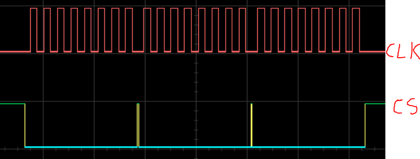

hjhjhj
Hi Daniel,
The Continuous Serial Communication Clock and Continuous Peripheral Chip Select Enable are activated,but the result is not what I want,because Chip Select (S) is always driven low .As for the EEPROM,Chip Select (S) must be driven high after the rising edge of Serial Clock (C) for the last bit of the instruction,in order to make sure the instructions to be accepted and executed.
Now the problem is that  Chip Select (S) should be  configurable to  be driven high at anytime.Can you help me solve it?

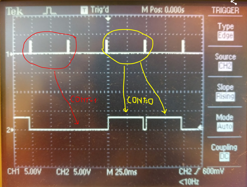

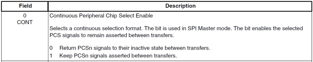

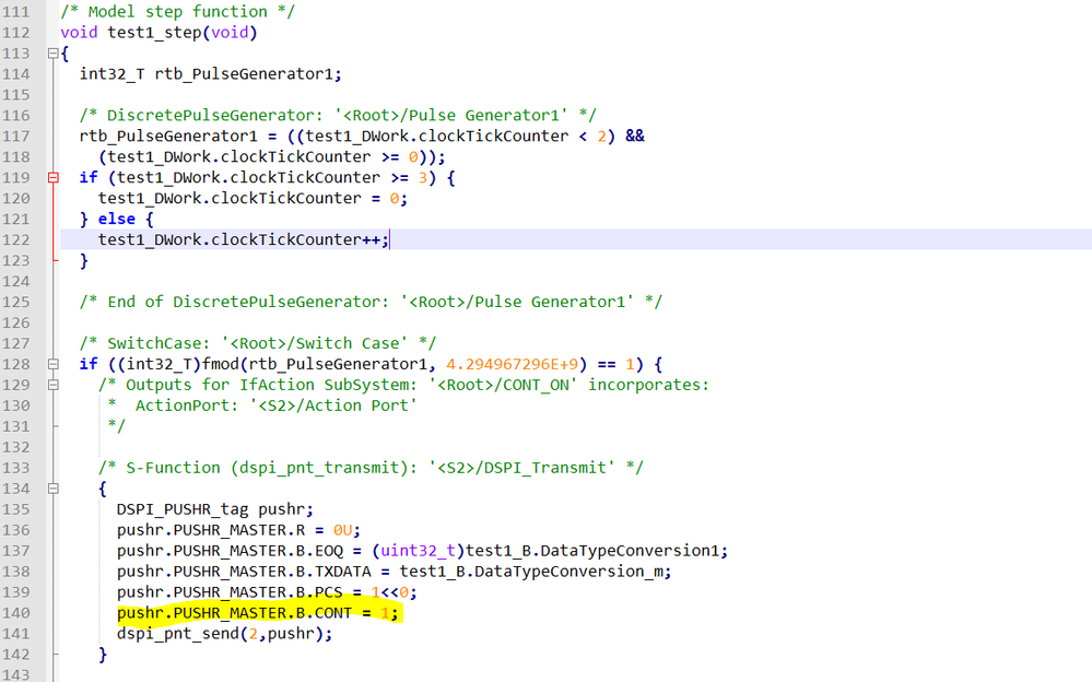

According with the MPC5744P reference manual, the SPI modules supports:
Programmable serial frame size: 4 to 16 bits
•    SPI frames longer than 16 bits can be supported using the continuous selection format.
As can be seen you will need to use the continuous selection format to achieve 32b transfers.
The SPI Transmit blocks supports the Continuous Peripheral Chip Select Enable option which set the CONT bit. If set to 1 (enabled) the Chip Select signal is kept low (active)
The generated code for transmit is injected into the Simulink Step function which is called based on the Solver Fixed Time Size (fundamental sample time)
This give us the possibility to control when to enable of disable such option.
In Simulink, there are multiples ways to implement the set/reset of this bit.
- one way is to use a switch block and selected between the transfers when you want the CONT bit to be 1 (continuously) and the cases when you want independent transfers CONT bit to be 0
- use a custom S-function builder to set only this CONT bit at the end of step function.
Attached is an example using the SWITCH block.
Using this example you will have to develop your own logic to select the timing when you wish to sent/receive continuous SPI messages. Also, keep in mind you have the EOQ bit that could help you to decide when/what to transmit.
Using this example i could set the SPI to send 2 msg@16bit continuously and then switch to 2 independent messages.
Hope this will inspire you to solve the issue.

hjhjhj
Hi Daniel,
      The datasheet of the slave is as shown in the attachment and I'm looking forward to your good news.
