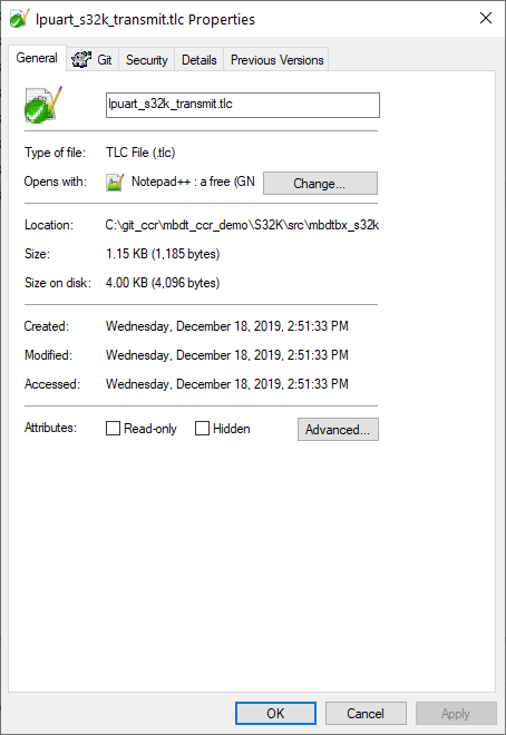

how to convert .zip to .mltbx. i am having issue in this step.
7,789 Views
constantinrazva
Hello sandeepsandeepky@gmail.com,
You can just rename the file from <toolbox>.zip to <toolbox>.mltbx
You can right click the file -> properties and in the general tab you find the name (in the example below the name is lpuart_s32k_transmit and the extension is .tlc; just rename the extension).
Hope this clears things up a bit.
Kind regards,
Razvan.

Actually the .zip extenction in that is not there. and even in that if I made in change it will be like .zip.mktbx extenction
7,789 Views
mariuslucianand
Hello sandeepsandeepky@gmail.com‌,
On Windows, in File Explorer, go to View and check the File name extensions. Now it will display the file name and its extension.
Now you can change the .zip extension file to mltbx.
Hope this helps,
Marius
