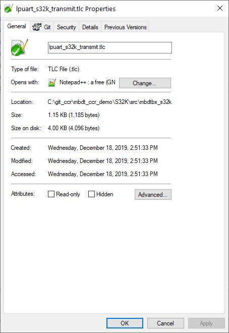

You can just rename the file from <toolbox>.zip to <toolbox>.mltbx
You can right click the file -> properties and in the general tab you find the name (in the example below the name is lpuart_s32k_transmit and the extension is .tlc; just rename the extension).
Hope this clears things up a bit.
Kind regards,
Razvan.

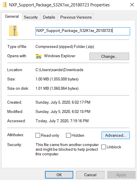

sandeepsandeepk
Actually the .zip extenction in that is not there. and even in that if I made in change it will be like .zip.mktbx extenction

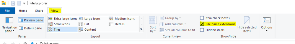

mariuslucianand
Hello [email protected]‌,
On Windows, in File Explorer, go to View and check the File name extensions. Now it will display the file name and its extension.
Now you can change the .zip extension file to mltbx.
Hope this helps,
Marius

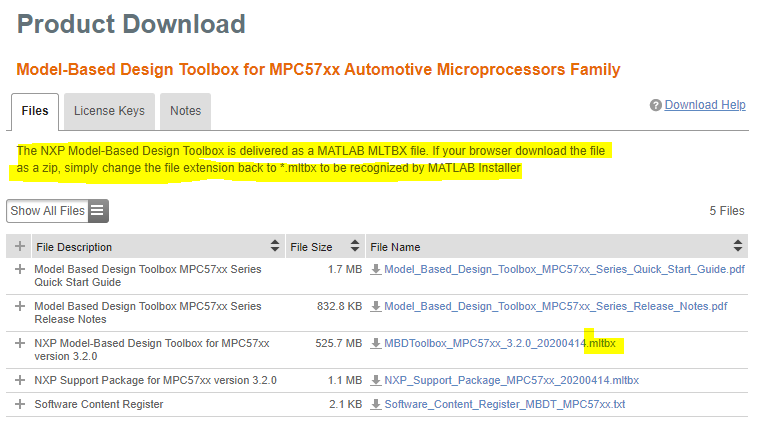

1. The approach that you are trying and the one mentioned in the thread that you sent us is to manually download the product from here https://nxp.flexnetoperations.com/control/frse/download?agree=Accept&element=11703517. As my colleague, constantinrazvan.chivu mentioned in that thread, if it is downloaded as .zip archive you simply have to change the extension from the .zip to .mltbxpastedImage_1.png

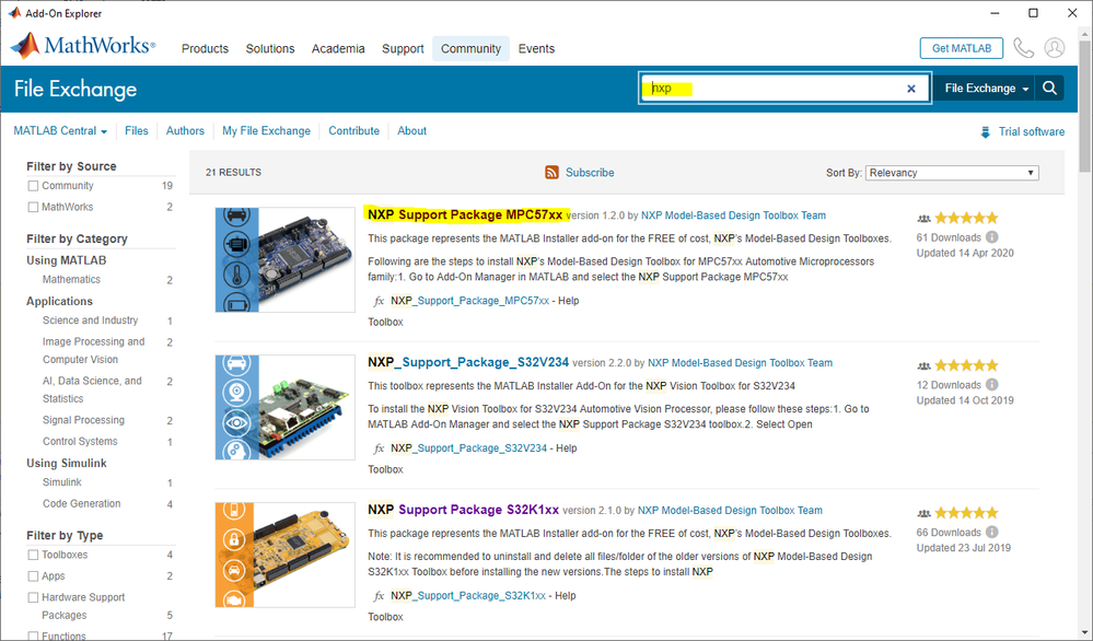

2. The second approach is to go to Matlab AddOns, search "NXP" and follow the steps for the tool that you are interested in.
