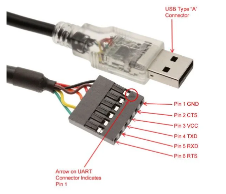

- Instead, to use another instance of LPUART, an additional connection of the configured Rx and Tx pins is needed. An USB2Serial Converter can be used for this procedure. The Tx pin on the board connects to the Rx pin on the USB2Serial Converter, and the Rx pin on the board connects to the Tx pin on the USB2Serial Converter.
- So TXD pin 4 in the image above connects to PTA28 pin on the board (J412.23), and RXD pin 5 in the image above connects to PTA27 pin on the board (J3.20).

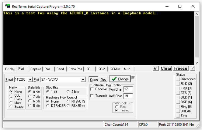

- After the connections are made successfully and the model is downloaded to the board, in the serial communication tool (for example RealTerm) connect the port corresponding to the USB2Serial Convert, NOT the board port, these ports being separate, but since we want the communication to be carried out using this converter, will connect to the port related to the converter.
After all these connections made successfully, you should be able to successfully communicate using the LPUART_0 instance.

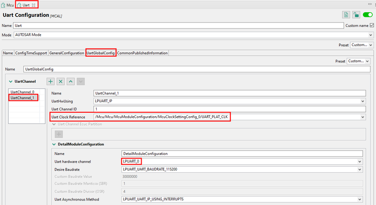

To change the LPUART instance used, LPUART_0 in your case, the following steps need to be followed:
- Make sure that the pins are available, not being used by another peripheral, and are correctly configured in the Port tab and in the Pins tab.

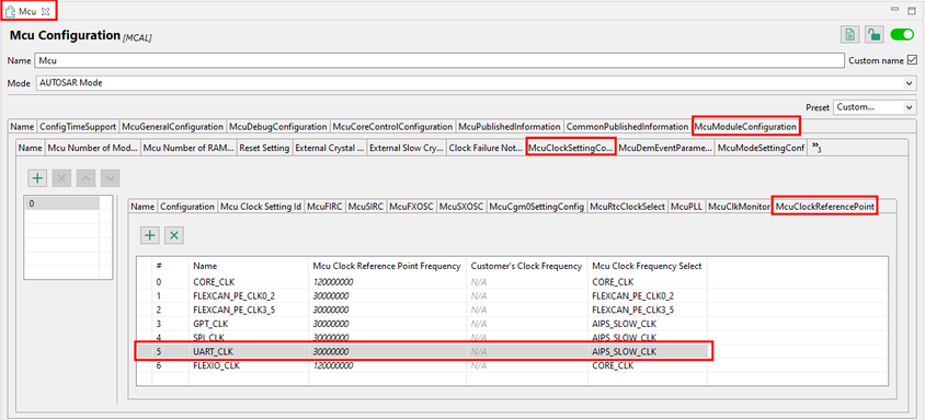

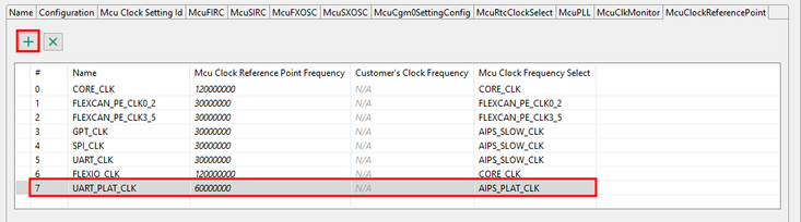

- Make sure that the instance you want to configure is correctly referenced to the clock value. You have selected UART_CLK, which is set to AIPS_SLOW_CLK. Based on the following table from the S32K3xx Reference Manual, the LPUART_0 is clocked by AIPS_PLAT_CLK. So you should either create a new clock, or modify the current value, but take into account this aspect of the clock at which each instance operates.

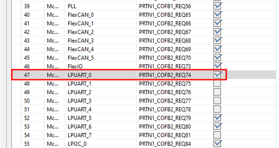

- You should enable the corresponding peripheral clock in the Mcu tab, in this case LPUART_0.

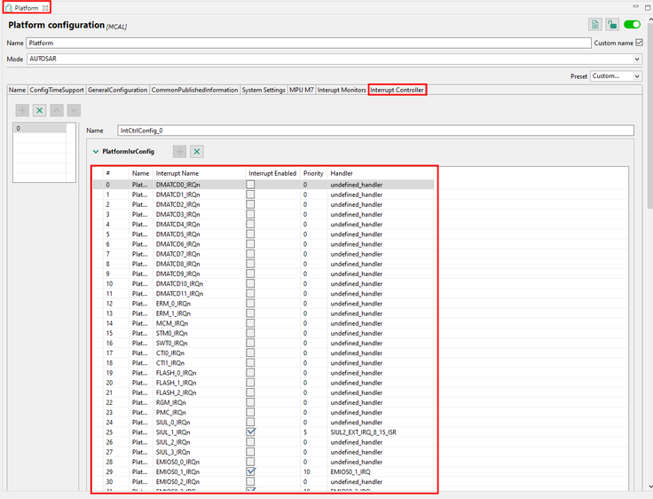

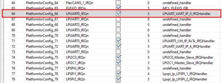

- Make sure that the interrupt is enabled for the corresponding instance, in this case LPUART0_IRQn, and set the Handler accordingly (LPUART_UART_IP_0_IRQHandler).
With these aspects in mind, you should successfully use the newly configured LPUART instance.

dragostoma
Hi, @SuperBeginner,
1. MCU Clock Reference
To create a new clock reference or modify the already existing ones, you should access the following path in the configuration tool:
Mcu tab -> McuModuleConfiguration tab -> McuClockSettingConfig tab -> McuClockReferencePoint tab
Here you will find all the references of the clocks:
As mentioned in the Reference Manual, S32K312 has only LPUART_0 that uses AIPS_PLAT_CLK, the rest of the instances use AIPS_SLOW_CLK.
So to make sure that the other instances can still be used successfully, you can create a new reference for the UART, clocked by AIPS_PLAT_CLK.
After that, you should make sure that the UART channel you want to use, which has the LPUART_0 instance set, uses the correct clock reference, the one we just created:

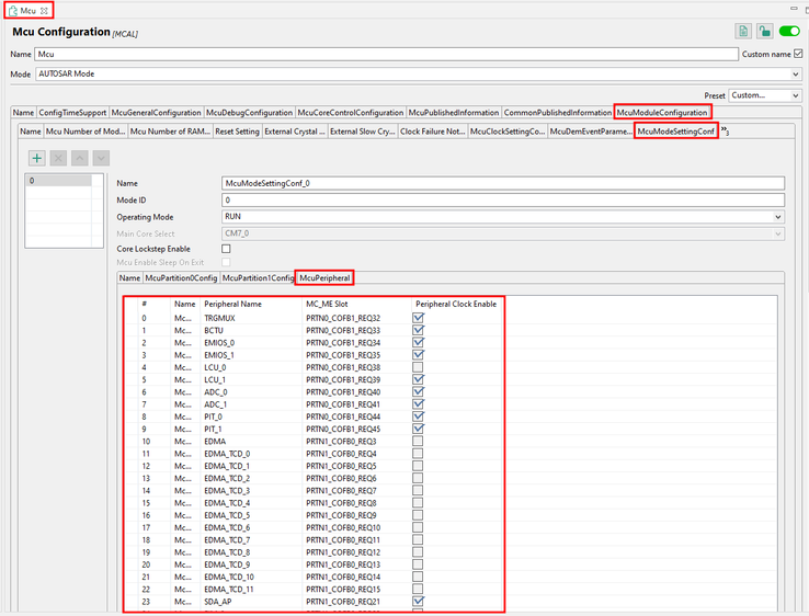

2. MCU Clock Enablement
To enable the clock of the peripheral you want to use, you should access the following path in the configuration tool:
Mcu tab -> McuModuleConfiguration tab -> McuModeSettingConf tab -> McuPeripheral tab
Here you will find the list with all the available peripheral clocks.
To be able to use the new instance of LPUART, the related peripheral clock must be enabled.
3. Interrupts Configuration
To be able to use the interrupt handlers, they must be enabled in the Platform tab, which can be found at the following path:
Platform tab -> Interrupt Controller tab
Here you will find the list with all the available interrupt handlers.
In order to be able to use the interrupt handler related to the LPUART_0 instance, it must be enabled, a priority must be set and it must be named based on the definition and implementation in the drivers MBDT generates code on top of. In this case will be LPUART_UART_IP_0_IRQHandler.
