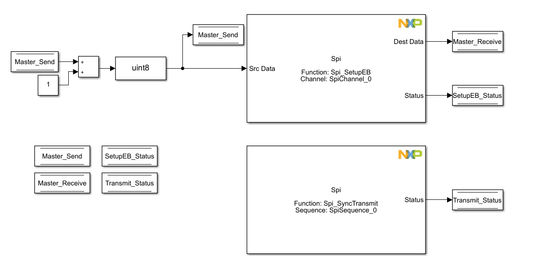

I have two questions regarding SPI communication development using MBDT:
  • How can I read or write n bytes (>2 bytes)?
    I have verified that 2-byte data transmission is working fine with the packet generator using the example project "s32k3xx_spi_async_interr_ebt".
    However, when I try to transmit 4 bytes of data (0xAA 0xAB), the EVB only receives the 0xAA data.
    I know this is quite normal, but I just want to provide an example to help you better understand my issue.

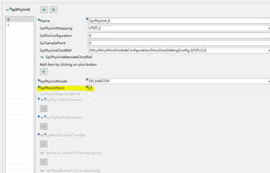

  • How do I develop synchronous transmit?

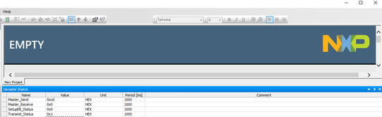

    I referenced the example "s32k344_spi_sync_master_ebt" and tried to start data transmission with LPSPI2, but it doesn’t work.
    I checked the status. "SPI_SetupEB" shows 0 and "SPI_SyncTransmit" shows 1.

Dear NXP,
Regarding the second question - "How do I develop synchronous transmit?", I found the answer myself.
I found this was an oversight on my part, I didn't enable SpiPhyUnitSync under the S32 Config tool.
This resulted in my SPI communication not functioning in synchronous mode.
