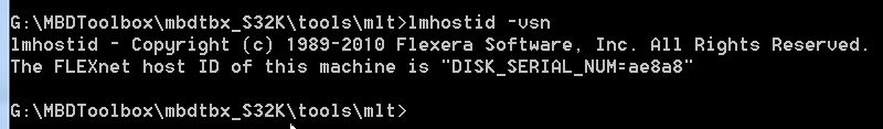

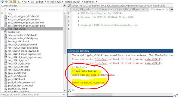

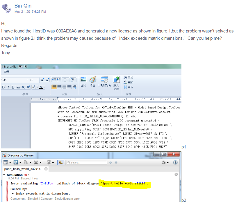

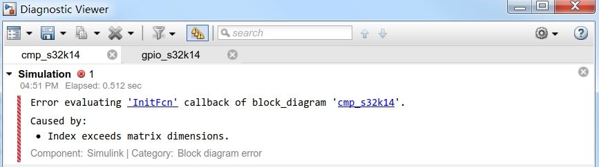

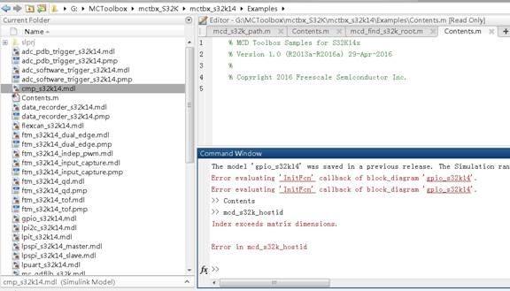

I am using S32K144 development board,and I would like to use Matlab Motor Control Toolbox for MATLAB / Simulink MBD supporting S32K1.0 library. After I open the example project and compile ,the error occurred as shown in figure 1.Also,the error occurred as shown in figure 2 when I installed the license.So I only can use DOS method to obtain Host ID as shown in figure 3,but the Host ID was ae8a8. Is there any association?Can you help me solve the problem?1.jpgp12.jpgp23.jpgp3

The problem is in the toolbox - it is now logged as AST-619. The DISK_SERIAL_NUM is always assumed to be 8 char long.
The license generation on the website works correctly and we can't change it.
We have a quick fix for you - kind request to test it again - an confirm the results. If that is OK we will publish a hot fix.
So,
Please replace there 2 files:
- {install dir}\MBDToolbox\mbdtbx_S32K\mbdtbx_s32k\mscripts\checkers\ folder mbd_s32k_cc_data_check.p
- {install dir}\MBDToolbox\mbdtbx_S32K\mbdtbx_s32k\mscripts\matlab_ui\ forlder mbd_s32k_hostid.p
Hope this time will work.
Thank you!

Daniel_Popa
Hi Tony,

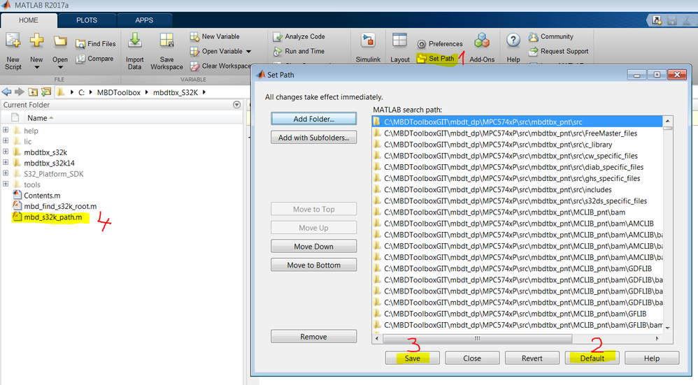

I see you have the same issue even if you try to run the simple m script that has nothing to do with the Simulink models.
Have you executed the mbd_s32k_path.m ?
We do not have such problems with our setups and we can't reproduce the issue you are seeing.
Please try the following:
- uninstall all Matlab toolboxes you have from NXP/Freescale
- Open Matlab and Set all paths to default
- Then Install the MBDT rev2.0 for S32K
- Run mbd_s32k_path.m
If you still have the issue then something is fishy with your setup and we will investigate together further on.
Thank you for your patience!

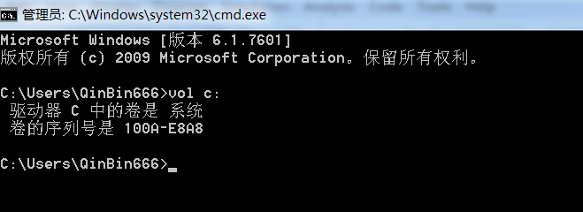

binqin
Hi Daniel,
I think I‘ve found the reason for this problem,but I can't solve it, it needs you to apply me the correctly license.
I solved it following steps:1、change my DISK_SERIAL_NUM as 100A8AE8(before  my  DISK_SERIAL_NUM was 000A8AE8) by a kind of software(   like  harddiskserialnumberchanger.zip). 2、restart the computer,and confirm the DISK_SERIAL_NUM has changed to 8 characters(before  my DISK_SERIAL_NUM was 5 characters ). 3、open   the example  project   and  compile, the problem was solved.   But  after I changed my DISK_SERIAL_NUM ,my computer can't access Internet and some software can't be opened.
I think the reason was license generated bug if DISK_SERIAL_NUM was shorter than 8.So I hope you can supply a correctly license to me.
Thank you very much.
Tony

Daniel_Popa
Tony,
So,
Thank you!

binqin
Hi Daniel,
Oh my God,the problem was solved.I feel like I'm always eating crabs for S32K , but you're very excellent.Thank you very much.

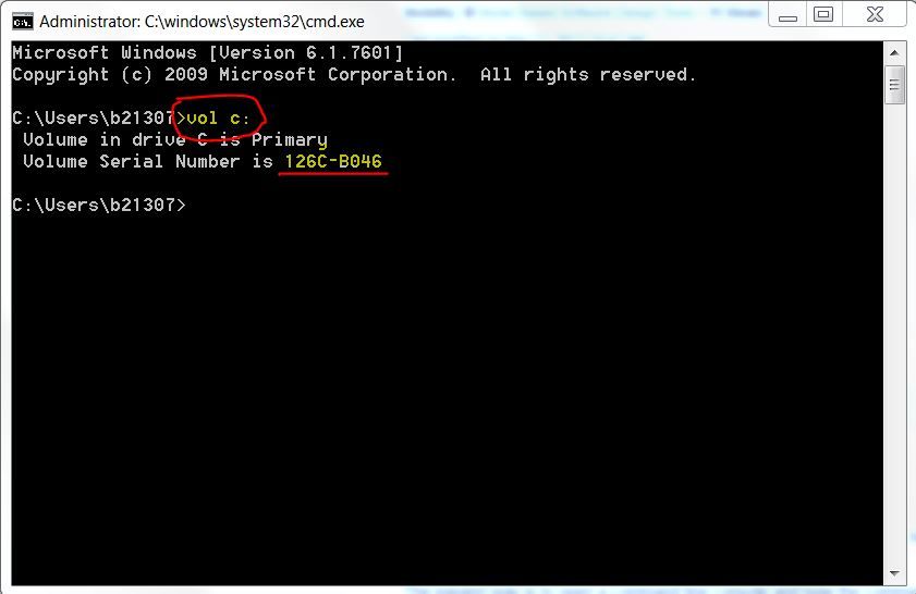

You may want to watch this video starting at 3.33 time where it's shown how to generate a license file. The procedure is the same.
The easiest way is to open a command line console and type the command>> vol c: (or whatever letter is assign on the partition you have installed the toolbox)
Also, keep in mind that you need to change the extension when you save the file on your PC. The file should be called license.lic
