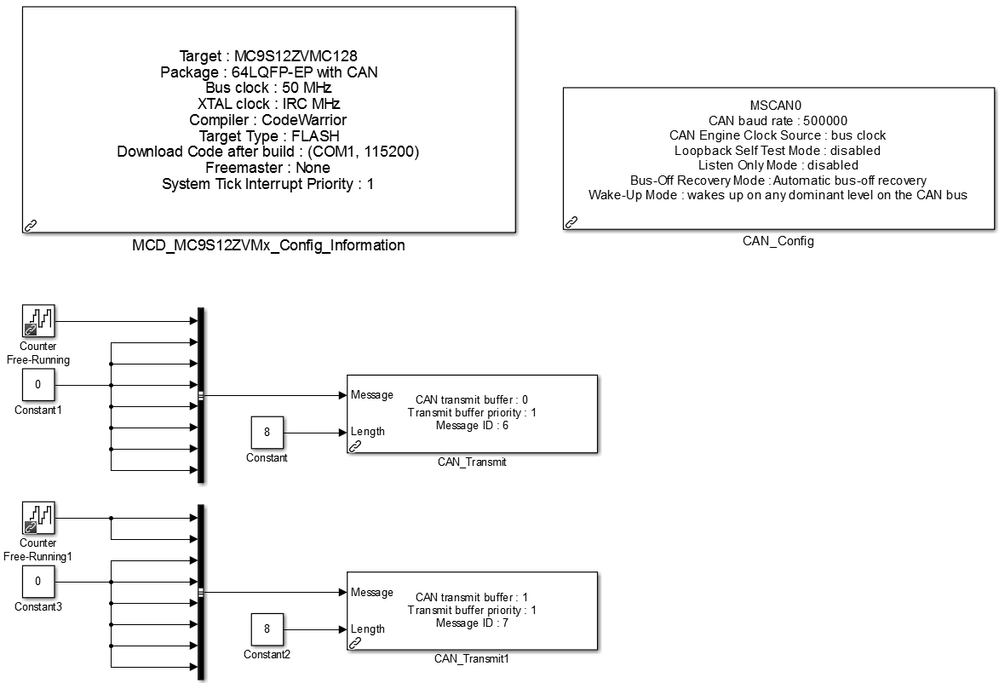

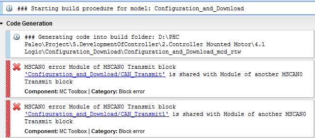

Hello~
I succeeded in sending one CAN message.
However, an error occurred when trying to send more than two CAN messages.
How do i send more than one CAN Message.?

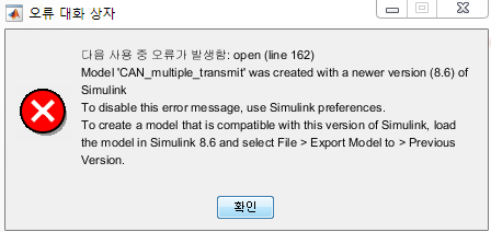

2)
My version of Simulink is 8.5.
You seem to be using version 8.6
So... I can not open your file because the version of Simulink is based on 8.6.
Can you upload it again with different versions?

Daniel_Popa
Hi eungsoolee‌,
Thank you for your time.
For #1 - it's my mistake i've not been paying attention to your exact target.
Since you are using s12zvmc128, then please use the new file attached mscan0_s12zvm.c and save it under  ..\mctbx_9s12zvm\mctbx_s12zvm\src\c_library folder.
Indeed the differences are minimal but it is recommended to use the new file.
For  #2 - please find attached a new version of the model. I save it with Simulink 8.4 to avoid any potential opening issues with newer version of Matlab.

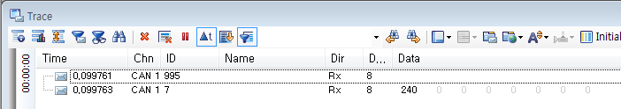

eungsoolee
I followed your advice....
But...The error message disappears in matlab, but the CAN application SW does not work properly.
                               <Snapshot of CAN application SW monitoring using CANoe>
Have you sent more than 2 messages using the model?
The attached file below is Application SW for CAN Test.
Can you check the wrong part of my model?

Daniel_Popa
Hi eungsoo Lee,
Let us try first to get rid of the errors and confirm you can sent more messages using this setup.
Go to your install directory for the toolbox and look for a file called: {install dir}\mctbx_9s12zvm\mctbx_s12zvmc256\mctbx_s12zvmc256\mscripts\mcd_s12zvmc256_block_mscan0_check.p
This file is responsible for consistency checks. Just rename the file extension from .p -> .none
This hack will prevent Matlab to load the functions for checking the consistencies.
Then, reload your model (it would be good to restart the Matlab) and compile. The error msg should be gone. Test your application to see if your get your msg sent over CAN network.
If the application works then we can give you a hot fix for this issue.
