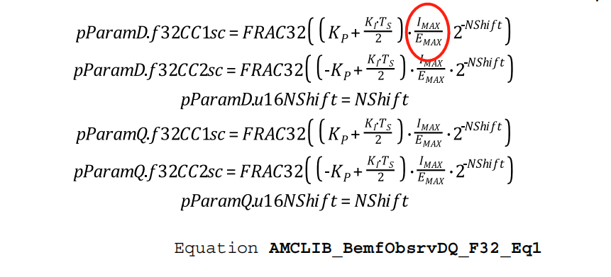

when I used the module of the function AMCLIB_BemfObsrvDQ, I have some question about parameter settings
 is the Imax equal to the Iscale, and the Umax is also,
if the Imax is not  equal to the Iscale ,the parameters is wrong,beacuse  the normalization uses Iscal,
so ,Ineed your help ,thank you very much!!!

lucabarbiero
The Max quantities are in practice the scaling factors, so for me Imax = Iscale and same for Umax. You need to use values that you know will never be exceeded. They could be the maximum inverter or motor current as described, but normally I use the maximum values which are measurable by the sensors. That's the real max in practice. If the sensors range is too wide, you may have a poor FRAC32 resolution. So choose whatever max values makes sense, but make sure you never exceed that, or you will have FRAC32 overflows!

董培董
yes, thank you very much
I think  Imax = Iscale and same for Umax, if Ichoose the max current ,then the current should be normalized according to the maximum value ,not the scal current,(Imax<=Iscal),so,I think it's the best to use the scale current.
