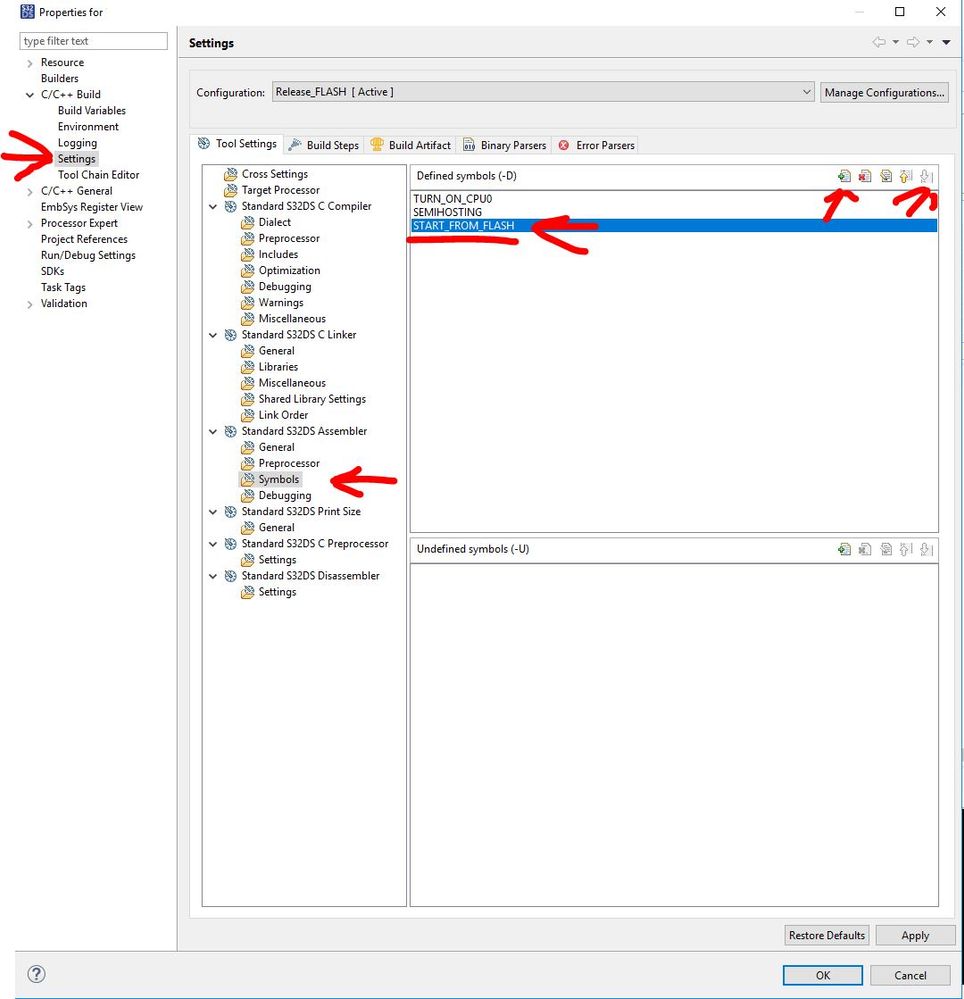

sebe
Okay, I have found a solution which works for me. The solution is in the S32DSv2.2 Project settings >> C/C++ Build >> Settings, then left to the "Standard S32DS Assembler" >> Symbols
I added there a "START_FROM_FLASH" and placed it on the bottom.
Now I can flash my microcontroller, can perform a power reset (disconnection + connection fro power) and it runs.
I think this is missing by default, when you create a new project with S32K116, without changing anything else.
