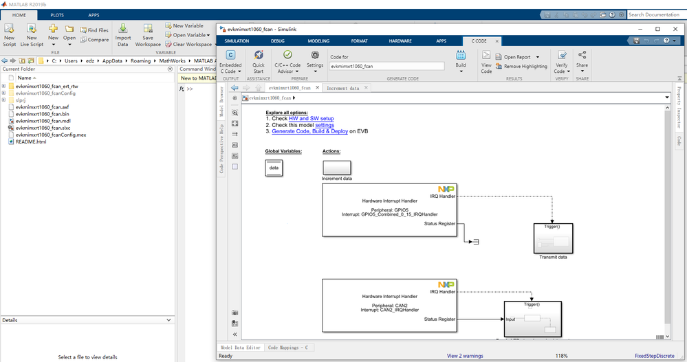

i just build the environment to develop RT1062 with MBDT tool,but when open a model,this fault appear.i don't how to figure it out and can find nothing.

Seeing now your screenshot with your workspace I've notice that the toolbox is installed in a location with spaces in its name. The JTAG download is using some windows bash scripts that don't perform correctly with spaces in its path. This should fix the download in via JTAG in FLASH memory.

assangeye
hello,
First i buld the model,to generate files, next i press "Simulink model folder",i find it can't export,and matlab command occur error.what's more,i find the xxxxx.mex file is be deleted.

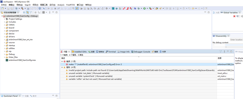

And if i press "To local filesystem",it export succeed .Then i import to MCU.IDE,and build the project.it also occour an error.

nxa11767
That's because of the spaces in the path. Can you install the toolbox in a path without spaces?

assangeye
Thanks for your help.i can work well now.
