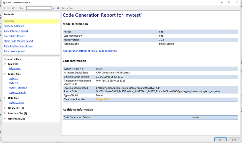

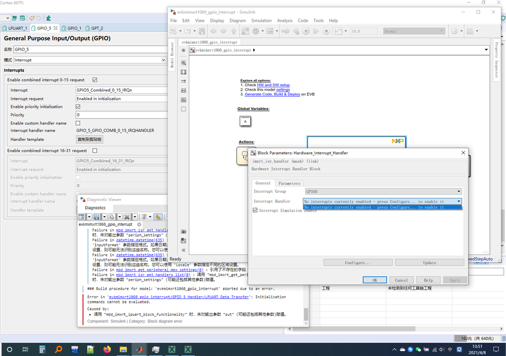

assangeye
But,i also have question on building zhe model. I am using Matlab2019a,i open the evkmimxrt1060_gpio_interrupt-simulink model,when i build the model,some error occour,and i try to figure out it by change the setting with MCUX_CFG.I press the update button which is in block parameters,but it doesn't work?Now i can't run any model,how can i do it?001.png001.png
29,194 Views
nxa11767
You followed the steps from that post and restarted afterwards the matlab?
The problems you see in the model will get fixed once the datetime error is fixed. The block should see that the interrupts on GPIO5 are already enabled in the .mex file, but it gets that datetime error in the process.
Additionally, after you make the datetime settings in the matlab preferences and your system, run a script that in found in the root of the toolbox folder: mbd_imxrt_path.m.
Alexandra

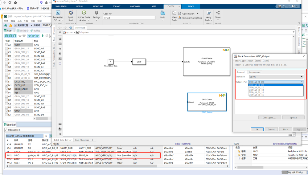

assangeye
Thanks for your early help,but there is a new problem,when i pin "M12",route to GPIO_AD_B1_03,and the signal is GPIO1_19.But i can't find the correct pin in my block setting.Is it a BUG?333.png333.png
29,119 Views
nxa11767
You need to specify in pins settings, in Configuration Tool, the direction: Input or Output.
The GPIO Output block will look for the pins configured with direction output in the Configuration tool. So in your case you should set Direction to Output, ctrl+s (to save the changes in configuration tool) and then press in simulink, in the GPIO Output block the Update button to see the changes.
BR,
Alexandra

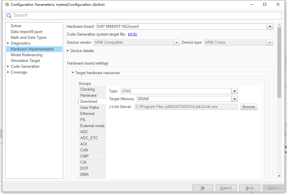

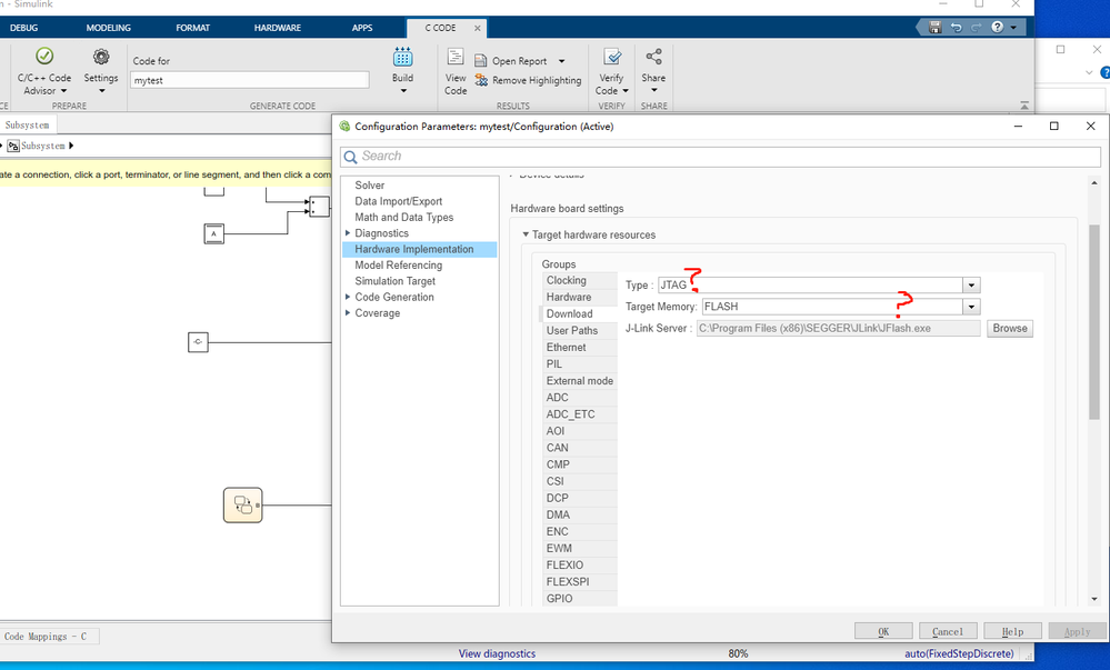

assangeye

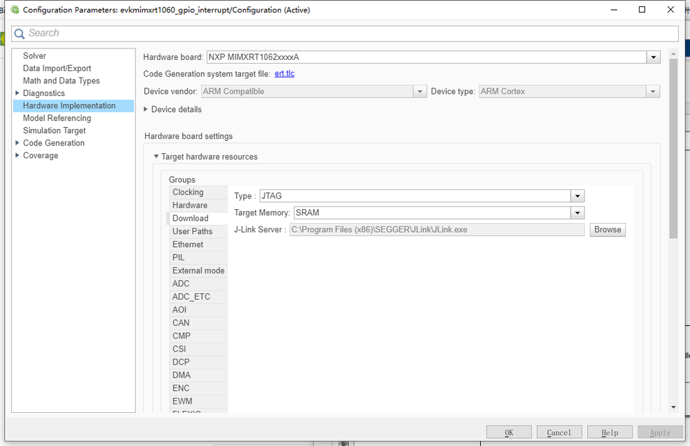

Thanks for help ,i have another question can i down the project via jlink? When i set jlink linking to board via SWD mode,and press build ,but it doesn't work.is there any other settings? i want to know what does this flash mean?is it mean RAM(addr:0x00000-0x20000)?becasue i have bootlaoder,and i need to know how to manage the memory to download files to the correct address.444.png444.png
29,098 Views
nxa11767
The target memory represents how the application will be linked: to run from FLASH , so the application will have addresses starting with 0x6000_0000 and will execute in place (XIP execution) or from internal OCRAM.
For using the JTAG option, you need to browse for JLink.exe instead of JFlash.exe (same Utility to be used if target memory is RAM).

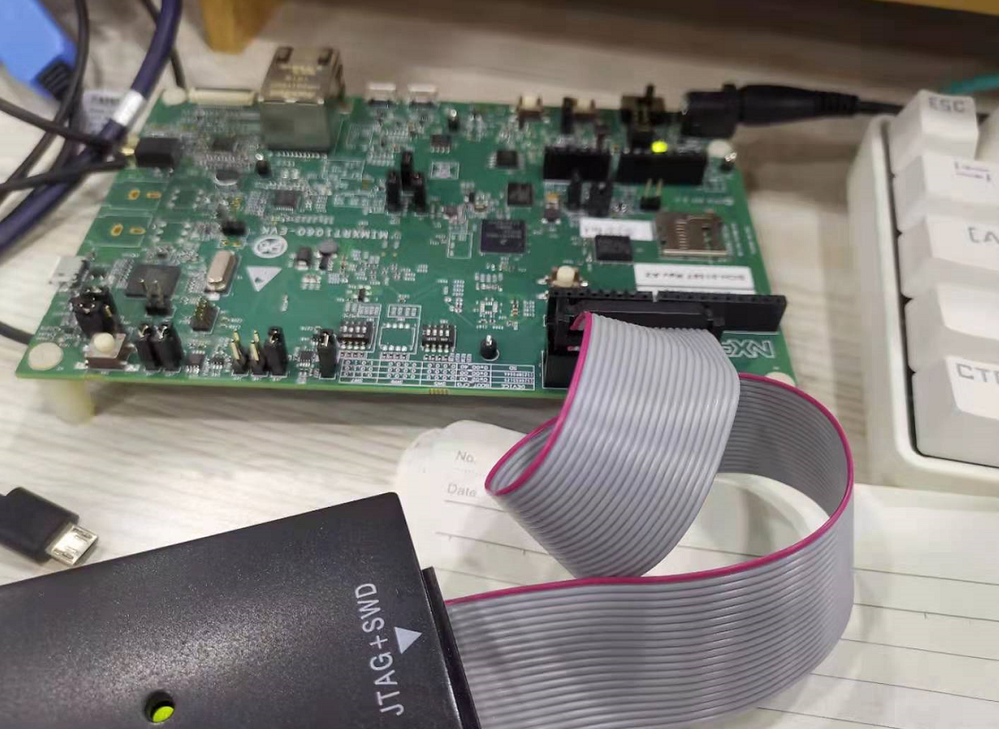

assangeye
Thanks for your help,i can download program to MIMXRT2060-EVK with OPENSDA.But when i change to using JATG to download the program,it seem doesn't work.First of i change the model config,the i press the "Build,Deploy&Start" button.Is there any other settings?
29,054 Views
nxa11767
In the build folder of the model, you'll find 2 files: script.jlink and program_board.log, Can you attach the two files?
If you switch to Flash as target memory and use JTAG as download is working ok?

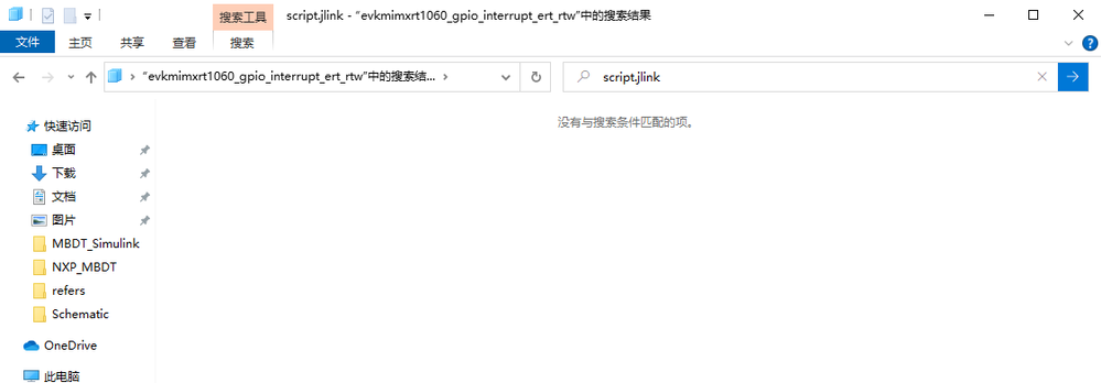

assangeye
hello,
i follow your suggest to find this files,but i find nothing.
And i try to download file to SRAM,i also doesn't work.
Finally,i read to RN file again,and i find this!Does it mean the modle doesn't support JTAG?
29,019 Views

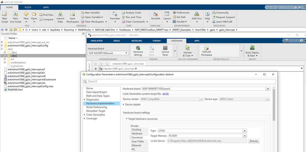

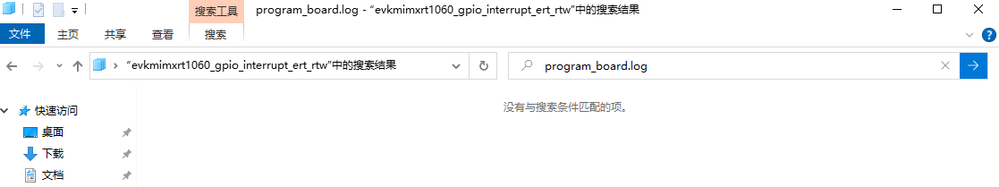

nxa11767
If you change the Target Memory from SRAM to FLASH, like below:
is flashing of the application via JTAG?
The script.jlink and program_board.log are placed in the same location as the <model_name>_ert_rtw folder.
I did some tests on my side for JTAG download on SRAM memory (internal memory) and indeed there's an issue there, but we plan a fix for the incoming release of the toolbox (end of April).

assangeye
hello,
i follow your suggest again,and i can't find this 2 files.when i change openSDA to JTAG to download program ,it seems doesn't start jlink service and do not have anyother message window.
what's more,when i import the project to MCUXpresso,and faild to build the project .So i doubt that if i choose the MBDT,i can't build to project with MCUXpresso anymore? But if i want to change the size of DTC or IDTC,how can i do that.

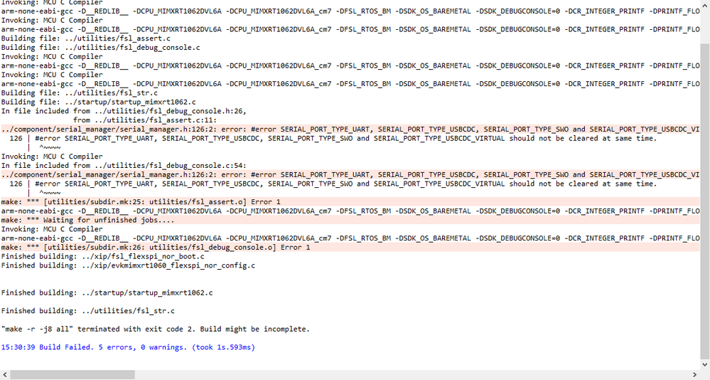

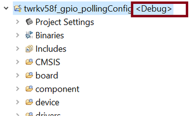

CauTran
Hi, I am following your instruction, but I had a problem. I don't know how to fix this. Can you help me to deal with this issue?
28,286 Views
nxa11767
Hi @CauTran ,
I see that you are trying to build the Release build configuration. Can you try with Debug build configuration? if you plan to do debug on the imported project will want to build it with debug information, so the Debug build configuration should be used.

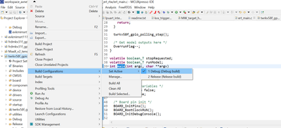

nxa11767
Hi @CauTran ,
Right click on the project and select Build Configurations->Set Active;
Alexandra
