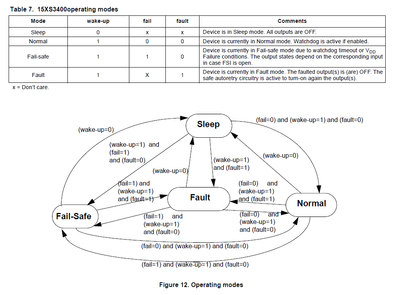

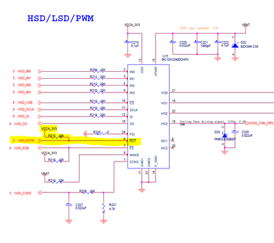

  I think I misunderstood the behavior of HSD driver (MC15XS3400) .

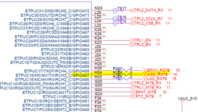

  All the HSD driver were enabled when we make the software which undefine the GPIO457 (HSD_RSTB) by MBDT.
  (I made this software and tried today.)
  I think undefine GPIO457 means GPIO 457 is high Z state, so HSD_RSTB is 1 because this pin is pull-up by VCCA_3V3.
  From the schematic, the voltage of wake pin is always supplied by VBAT.  This issue would be occurred when wake-up = 1, and RST = 1.
  I can't find the description about this condition from the spec sheet of  HSD driver (MC15XS3400) .
  https://www.nxp.com/docs/en/data-sheet/MC15XS3400.pdf
  It looks we have to change the wiring of this board (RDVCU5775EVM) for fix this issue.
  How do you think about this?

 Thank you for reporting this behavior. Most likely the GPIO pins connected to the HSD remain in a high Z logic state during the bootloader and the HSD remains configured. A quick fix for that would be to ask my colleagues from the RAppID bootloader to put the HSD in a reset state while the MCU runs the bootloader. Do you think this might solve the issue?
