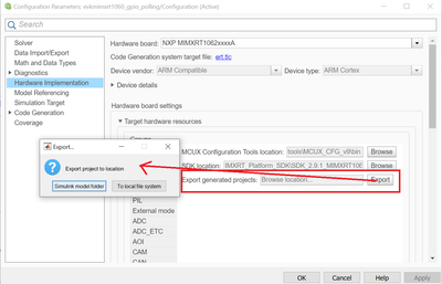

19,510 次查看
nxa11767
Seeing now your screenshot with your workspace I've notice that the toolbox is installed in a location with spaces in its name. The JTAG download is using some windows bash scripts that don't perform correctly with spaces in its path. This should fix the download in via JTAG in FLASH memory.
When downloading via OpenSDA, the JLink is not used but the Integrated OpenSDA USB CMSIS Debug and Programming adapter.
About importing in MCUX IDE, the toolbox has an option of exporting the project to make it buildable in MCUX IDE (meaning building all the links to the generated simulink folder, the .mex file used and the compilation/linker flags used from simulink). The option is available in Model Settings -> Hardware Implementation -> Target Hardware Resources-> User Paths, Export generated projects
As export option:
 - Simulink model folder - will just update the <model_name>Config project in the current location of your model, and in this way any change you do in the MCUX IDE will be seen in Simulink and the vice-versa.
- To local filesystem - choose another path to save the <mode_name>Config and <model_name>_ert_rtw folders.
When importing in the MCUIDE the <model_name>Config folder I recommend to not use copy project into workspace because some paths might break. After importing you can change the settings of the project from the MCUX IDE - like memory sizes, linker files etc, from project settings. Also for this export option is better if the toolbox or current location of the model is in a path without spaces.
 If you want to change from simulink memory sizes, you must change the linker files for the project. Those are found in the <model_name>Config/linker_files folders, flash or ram folder depending on the Target Memory selection.
BR,
Alexandra
