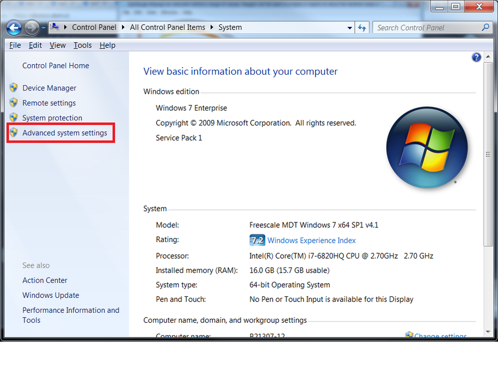

Step 1: Go to System/Advanced system SettingspastedImage_1.png

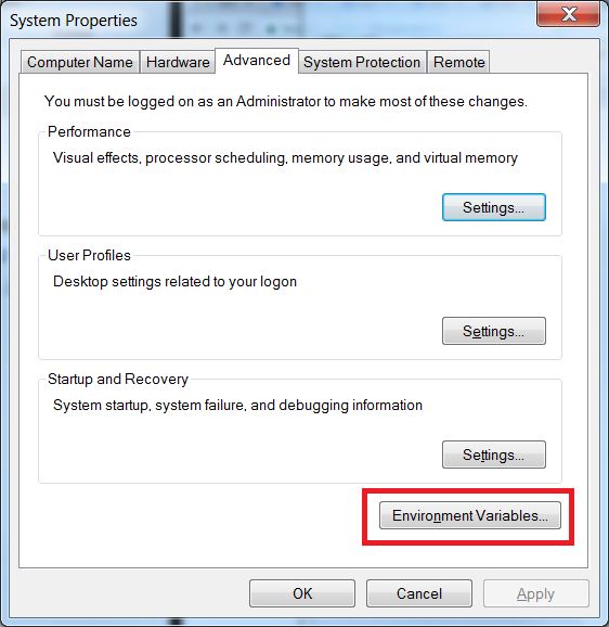

Step 2: Select the Environmental Variables

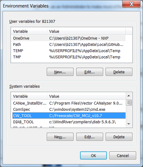

Step 3: Add a new System Variable
Additionally you can check the video embedded in the https://community.nxp.com/thread/451240 at 5'10''
Hope this helps!

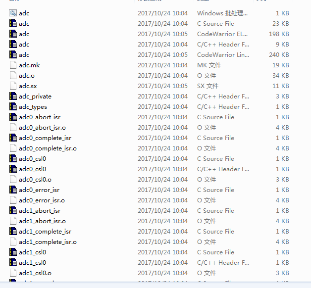

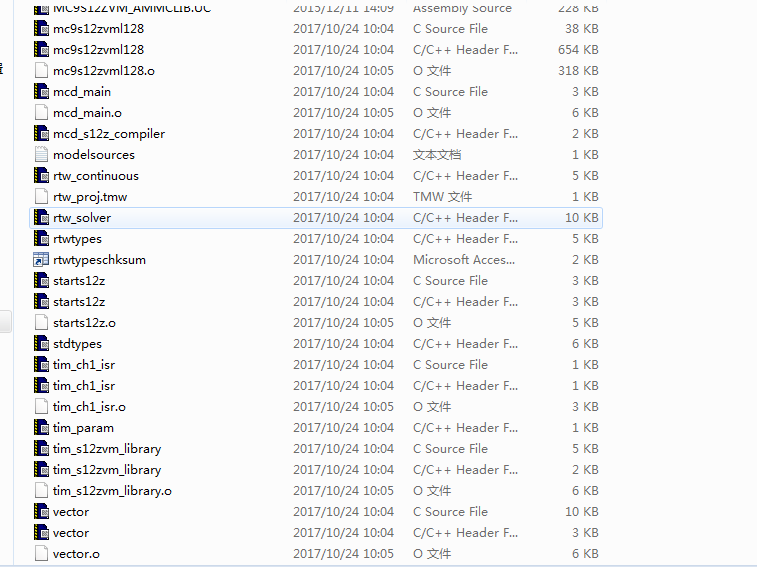

zhuaoci
hello daniel,
          Why does the automatically generated code have no project  files?
