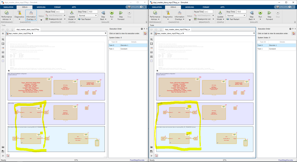

12,813件の閲覧回数
mariuslucianand
Hello @stefan_zamfires ,
Oh, now i've got it! Well, during my debug process, before figuring out that the problem was related to the interrupts, I've changed the execution order of the receive vs transmit (master, slave) to execute first the slave block. So the data that needs to be transferred by the slave is buffered before the actual transmit happens.
Here you can see that in the left side (your initial model) the send is executed before the receive block while in the right side( the model that I've sent you) the receive block is executed first.
Now, SImulink allows you to change the execution order (also the order in which the code is generated) by setting a Priority to the block. To do that, you have to right click on a block, go to Block Properties and type the desired Priority.
Hope this helps,
Marius
12,786件の閲覧回数
stefan_zamfires
Hi Marius,
Thank you for your reply.
I have tested my model with new priorities and now I can see the SPI comms.
However I think this is not a trivial change, neither the one for ISR priorities in the tlc file. I guess spotting these things comes with experience.

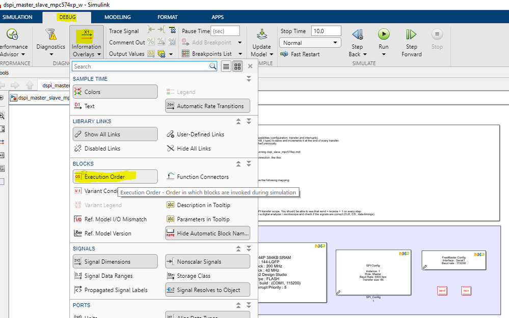

I think the problem is solved now and I thank you very much for your support. I would like to ask a few more questions, they are still related to the topic in question, but are not strictly about the problem:
1. Can we make sure we capture these changes in the next release of the toolbox? It would be good if the examples for SPI at least were fully functional straight out of the box.
2. The view in the screenshots you sent, where you can view the Information Overlays and the Execution Order of different block is quite useful. Is there a way I can bring it up for my model too?
3. You mentioned you can change the order of code generation, how do you do that? Is it also by changing Priorities in the block Properties?

12,781件の閲覧回数
mariuslucianand
I will respond to each point:
1. Yes, once we have the client confirms the changes are integrated into our toolbox and the next release contains them. We also have a patch page for each of the release ( not available yet, due to community platform migration) that contains all the changes. Well, the examples that come with the toolbox are tested and functional but for SPI, on MPC5744P we recommend using two boards, one configured as master, other as slave. In that scenario, the test passed. But thanks to your use case, we have now found the bug and solved it.
2. The view in the screenshots I've sent are available in newer matlab versions. I tried 2020a. It can be enabled from DEBUG > Execution Order. For older matlab version, pressing Ctrl+D will show the execution order in the upper right order of the each block.
3. Yes, I've mentioned in the previous response on how to change the Simulink priorities. When generating code, Simulink will take into consideration the priorities of the blocks. Also, this thread here https://community.nxp.com/t5/NXP-Model-Based-Design-Tools/MBDT-blocks-for-measuring-Idle-Time-or-Pro... explained by my colleague @constantinrazva explains how the C code looks like.
