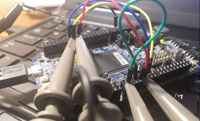

I am trying to setup SPI on the MPC5744P EVB Rev D board with MBDT. I tried the following:
1. MPC5744P slave, S32K144 (EVB) master
2. MPC5744P slave, ATmega328P master with an Arduino board
3. MPC5744P slave with same MPC5744P as master using two instances of SPI on the micro as per the picture attached.
Pin connections of the two instances are as per the model description captured in the attach.
Phase is set to 1st edge and polarity active low for both instances.
Variables recv and slave are set to volatile and send to ExportedGlobal.
Model runs at 100ms.
I have a feeling I am missing something and I'm not sure what.
Can someone give me a hand with this please?

I have double cheked and the Transfer Mode = Non-Blocking for both SPI instances.
I have attached the model, the flash file (+map) and a picture with the board setup for your reference.

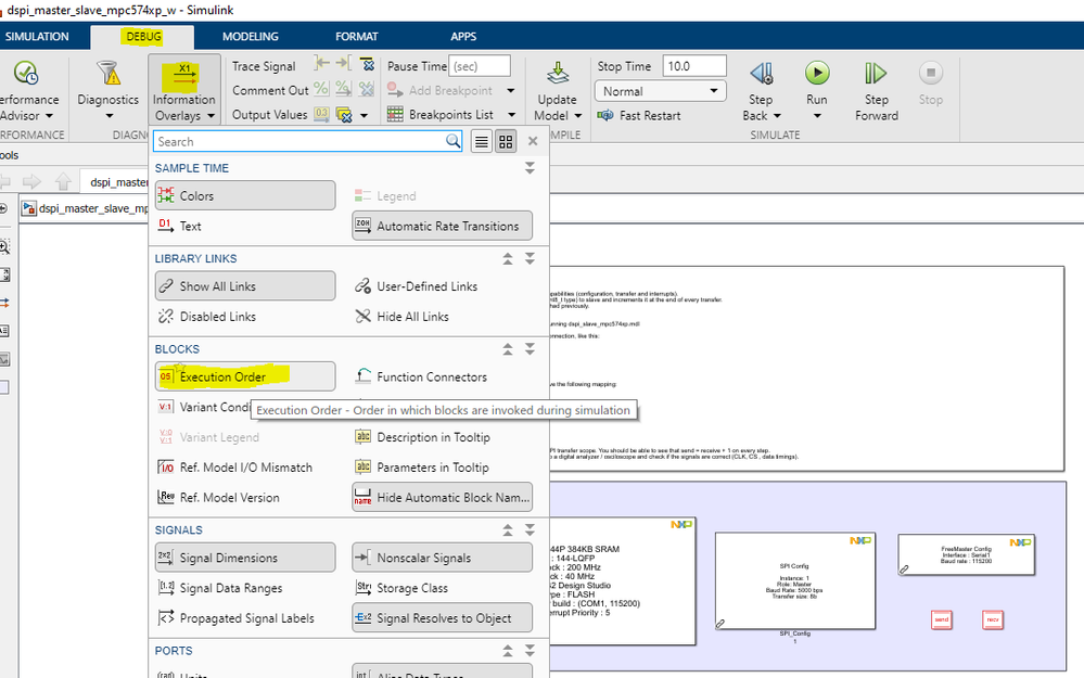

Oh, now i've got it! Well, during my debug process, before figuring out that the problem was related to the interrupts, I've changed the execution order of the receive vs transmit (master, slave) to execute first the slave block. So the data that needs to be transferred by the slave is buffered before the actual transmit happens.
Here you can see that in the left side (your initial model) the send is executed before the receive block while in the right side( the model that I've sent you) the receive block is executed first.
Now, SImulink allows you to change the execution order (also the order in which the code is generated) by setting a Priority to the block. To do that, you have to right click on a block, go to Block Properties and type the desired Priority.

2. The view in the screenshots you sent, where you can view the Information Overlays and the Execution Order of different block is quite useful. Is there a way I can bring it up for my model too?

2. The view in the screenshots I've sent are available in newer matlab versions. I tried 2020a. It can be enabled from DEBUG > Execution Order. For older matlab version, pressing Ctrl+D will show the execution order in the upper right order of the each block.
