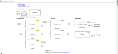

Currently we are working in SPI communication in MBDT with MATLAB, and we checked the SPI communication with example model (s32k3xx_spi_async_interr_s32ct) using S32K312-Q172 EVK board.
And we are facing an issue that SPI master sends the data and gets incremented but slave doesn't receive the data.

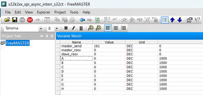

We checked the results in freemaster tool
In that result, master_send sends the data to SPI master & but slave_recv doesn't receive the data.

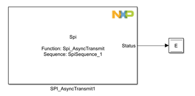

And we have checked the status of each block in SPI example model, we seen that "SPISequence1" throws error.
Vijay98_3-1744724565848.pngVijay98_3-1744724565848.pngVijay98_4-1744724584501.pngVijay98_4-1744724584501.png
