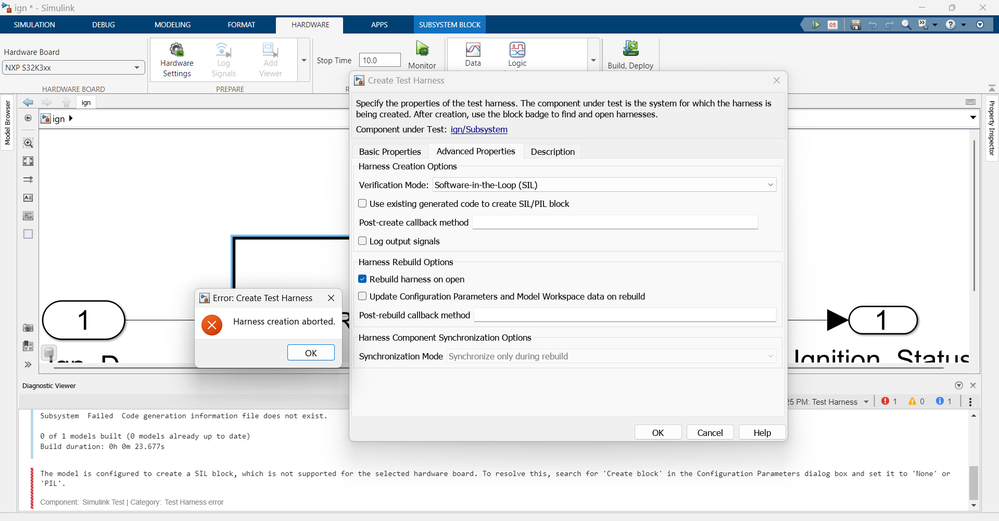

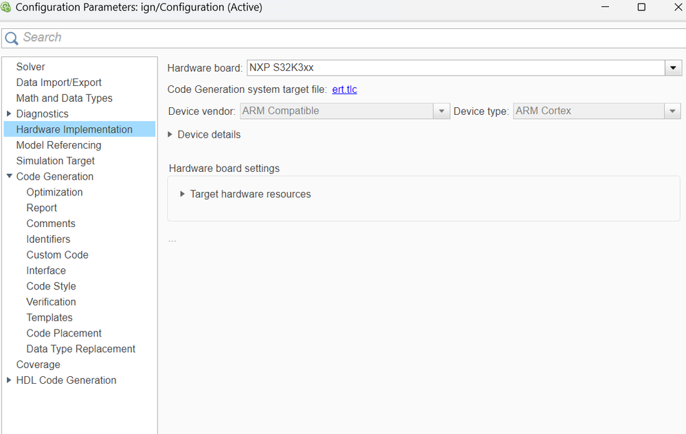

We are encountering an issue while attempting to create a SIL test harness for our model using the NXP S32K3xx hardware board. The error message "Error: The model is configured to create a SIL block, which is not supported for the selected hardware board. To resolve this, search for 'Create block' in the Configuration Parameters dialog box and set it to 'None' or 'PIL'" persists, even though the 'Create block' setting is already set to 'None'.
Model and Hardware Configuration Details:
  • Hardware Board: NXP S32K3xx
Steps Taken to Troubleshoot:
  1. Verified 'Create Block' Setting: Double-checked the 'Configuration Parameters' dialog box to ensure that the 'Create block' setting is indeed set to 'None'.
Tried this but still getting the same error.
We have attached an image of configuration parameter of our model and the error message for your reference.
We kindly request your assistance in resolving this issue. Any guidance or suggestions would be greatly appreciated.
Thank you for your time and support.

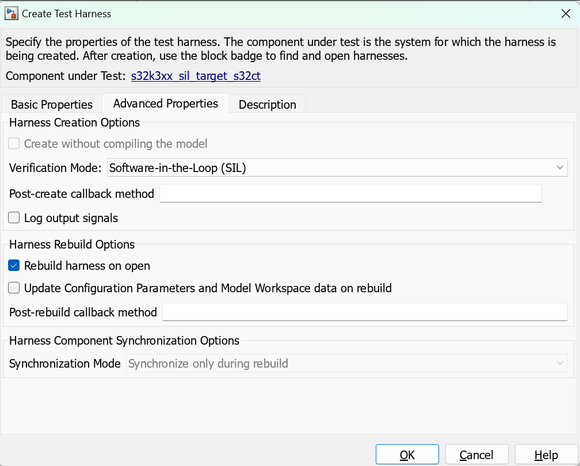

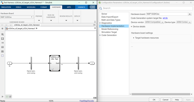

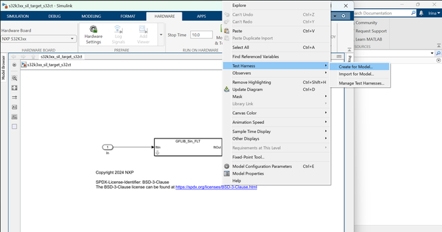

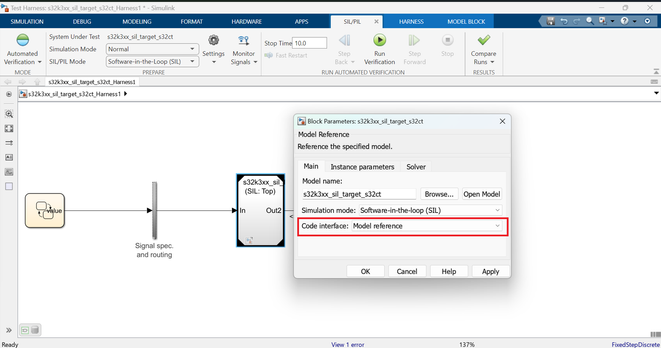

Hello @db_1008

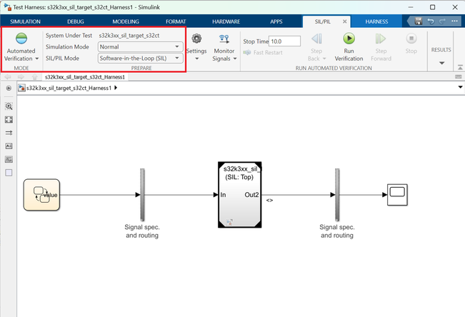

For trying to investigate the issue you have encountered, I have performed the following steps:
1. Opened the s32k3xx_sil_target_s32ct.slx file, delivered with the toolbox inside the following folder - {toolbox_installation_path}/S32K3_Examples/sil/s32k3xx_simple_s32ct
2. Right clicked the Simulink model canvas and chose Test Harness - Create for Model. In the opened Create Test Harness tab I have completed the Advanced Properties tab with the same settings as the ones you attached inside the SIL_Harness_Creation.png
3. When opening the harness model, and inspecting its properties, I am noticing that the model is created being set for the NXP S32K3xx.

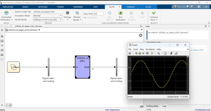

4. Added inputs and outputs inside the harness for performing a SIL simulation
5. Set the Code Interface as Model Reference for the SIL block inside the harness model
6. From the SIL/PIL tab, I am able to successfully run an Automated Verification
Could you please let us know if this is the use case that you are trying to achieve, and check if these steps also work on your setup?

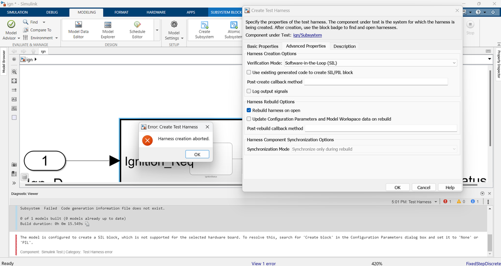

Hello @Irina_Costachescu
We are following the same above mentioned steps. but getting an error while creating test harness. please find attachment image of the error as well as the model zip file.
Hardware Board SettingHardware Board SettingError MassageError Massage
the model for which we are creating a harness already configured for an S32K3 hardware board.
The version are :
Matlab Version = R2023b
NXP Toolbox version = Model-Based Design Toolbox for S32K3xx Series Version 1.5.0

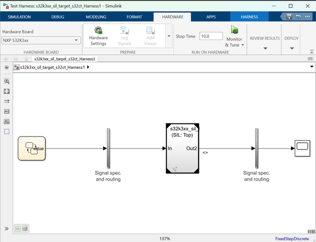

Irina_Costachescu
Hello @Abhijeet-Starkenn
I have taken a look and tried to create test harnesses for the model attached, and by following the steps mentioned in the previous reply, I was not able to reproduce this error.
However, I have managed to reproduce it by trying to create a Test Harness for the Subsystem placed in your model, instead of creating it for the model itself.
While we furtherly investigate the possibility of creating Test Harnesses for subsystems inside a model, would it be a suitable approach for you to create the Test Harness for the model itself?
Could you please provide more details on the use case that you are trying to achieve so that we could provide more tailored guidance?
For following this proposed workaround (create the Harness for the model), right click on the model canvas and choose Test Harness - Create for Model, as it is described in the Step 2 of the previous reply I have added to this thread.

Abhijeet-Starkenn
 Hi @Irina_Costachescu
Could you please proceed with setting
Test Harness -> Create for subsystem -> Advanced properties ->
Verification Mode: Software-in-loop -> Ok.
After this steps, on my system i am getting error "Harness creation Aborted" with error "Error: The model is configured to create a SIL block, which is not supported for the selected hardware board. To resolve this, search for 'Create block' in the Configuration Parameters dialog box and set it to 'None' or 'PIL'."Screenshot 2025-02-24 172625.pngScreenshot 2025-02-24 172625.png

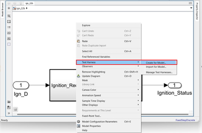

Irina_Costachescu
Hi @Abhijeet-Starkenn
As mentioned in my previous reply:
I have managed to create a Test Harness by right clicking on the model canvas and choosing Test Harness - Create for Model, instead of Create for Subsystem.
Do you need specifically to create harnesses for subsystems, or is this proposed approach (creating the harness for the model itself) helping you in your use case?
