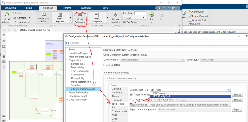

I intend to develop a PMSM control application for the Steer-by-wire system using an S32K3 controller. For now, we would like to test the algorithms developed by NXP for S32K144 + DevKit-MotorGD board, but since there is no direct porting on s32k3 they need to be rewritten. SFIO toolbox would help us to test some blocks from AMCLIB (for example clark) directly on the S32k344EVB257ND board with which we intend to develop the application. Meantime, I also bought S32k344EVB-172. And from here I would like to ask you a second question. Where are the two Model Based S32K3 examples for BLDC and PMSM engine, the S32DesignStudio 3.4 project for them, and the example for FreeMaster MCAT? In S32K3xx_AMMCLIB_RTM_1_1_27, respectively MBD Toolbox for S32K3xx 1.1.0 these are not found. These examples are described in chapter.3.3- Motor Control examples from the pdf manual.

With the MBD Toolbox for S32K3xx 1.1.0, we do provide both PMSM and BLDC Simulink examples configured for the S32K344 Q257 MCU, tested and developed on the S32K3X4EVB-Q257 and the GD3000, while the MCU peripheral configuration is performed in EB Tresos. Unfortunately, we do not deliver the S32CT examples in this release, and also the integrated AMMCLIB is 1.1.26, not 1.1.27. But both models come with the FreeMaster MCAT projects associated with them.

The only toolbox capable of generating C code for the S32K3 is the MBD Toolbox for S32K3xx 1.1.0, so there is no SFIO toolbox to generate such code. If you want to test the Clarke Park Transforms on the S32K3, please have a look at the s32k3xx_ammclib_gmclib_foc_(F16/F32/FLT) examples. They are using the AMMCLIB 1.1.26 for the S32K3, the integrated AMMCLIB library for this release.
To be able to run this model using the S32CT, you have to open the Simulink model, go to Hardware Implementation, Tools Paths and select the S32 Config Tools.
