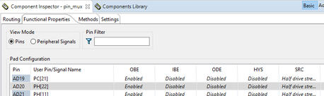

Referring to the schematic for CAN Bus #2 of the MPC5775B Reference Design:
And S32DS Component Inspector to translate MPC pins to convention used by MBDT:
The only CAN Bus selection that includes these pins is CAN Bus 3:
However, CAN Bus 3 is not available in the pick list for the FCAN Send block:
This blocks us from using the second CAN Bus interface of the MPC5775B EVB.
This looks like a bug in MBDT.

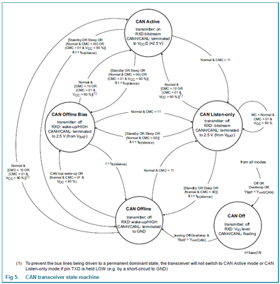

Hello, Sir
 I think you have to communicate with TJA1145 by dspi to let TJA1145 enter the 'CAN Active Mode'.
   Did you do this?
   When I tried to use MCAN2, I have to send messages to TJA1145 by dspi. I've succeed to get message with this method. (I used MCAN blockset.)
   TJA1145.fm (nxp.com)

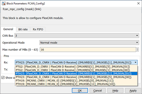

The FCAN Receive block has the same problem:
The FCAN Rx Complete block is ok, the pick list includes Can Bus 3:
The result is that MBDT can neither send nor receive on the second CAN bus on the MPC5775B EVB.

Hello @rsating ,
Indeed, it is a bug in the toolbox. I attached a patch that should show all the FlexCAN instances.
Steps to apply the patch:
1. Download the attached zip file and unzip it.
2. Run mbd_find_mpc_root() in Matlab to get the root folder there the MPC57xx toolbox is installed.
3. Close Matlab.
4. Open the mpc57xx_flexcan_patch.exe file and extract it's contents to the root folder. Press Yes to ALL when asked.
