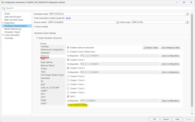

I've encountered issue with trying to compile and generate code for example project, "mTopR52_SPF_multiCPU".
This the error I'm getting:
So I tried running the script:
mbd_s32ze_build_multicore('mTopR52_SPF2_MultiCPU')
but I got the following error:
Unrecognized field name "Core_type".
Error in mbd_s32ze_build_multicore>@(x)mbd_s32ze.nxp.target.get_target_core(x.Core_type)
1 返信
1,691件の閲覧回数
vladmitroi
What MATLAB version are you using ? You might try to run the mbd_s32ze_path script in command line, followed by a sl_refresh_customization and restart MATLAB.
Also, verify that multicore is enabled from Hw Settings->Hardware Implementation->Multicore and try building with Build Selected Nodes button.
As a notice, for using the SPF2 core, a premium license is needed and a processor with DSP/ML option enabled. Please contact NXP sales team if you do not have such a license.
