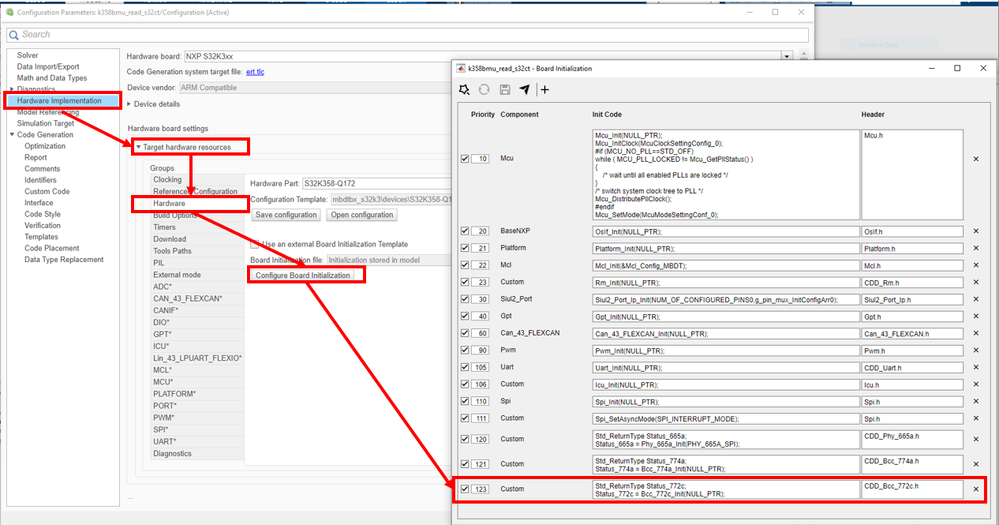

1. Is there anything to be done in configuration to remove Battery Junction Box ?
There are three main components/locations related with the Battery Junction Box: hardware configuration, BCCs initialization and the communication with the BCC at runtime.
  1. The hardware configuration is achieved through the S32CT or EBT, in this case the S32CT. These components related with the BJB are: Bcc_772C, and the Bms_common where the settings related to the BJB and Transactions descriptors are stored, while the Phy_665a contains mainly the TPL type of the TPL busses configured in the transceiver. To be honest, if you don't have a BJB for now, you can leave the settings untouched and get rid of the configuration later, if no BJB will be added to your system.
  2. Hardware Initialization: Initialization is performed into 2 main parts:
    1. Board Initialization, which configures the BCC_772C RTD driver component. This entry is configured from the Model Settings, and initializes the BCC_772C component. It can be disabled following the pattern below:mariuslucianand_0-1732119979130.pngmariuslucianand_0-1732119979130.png

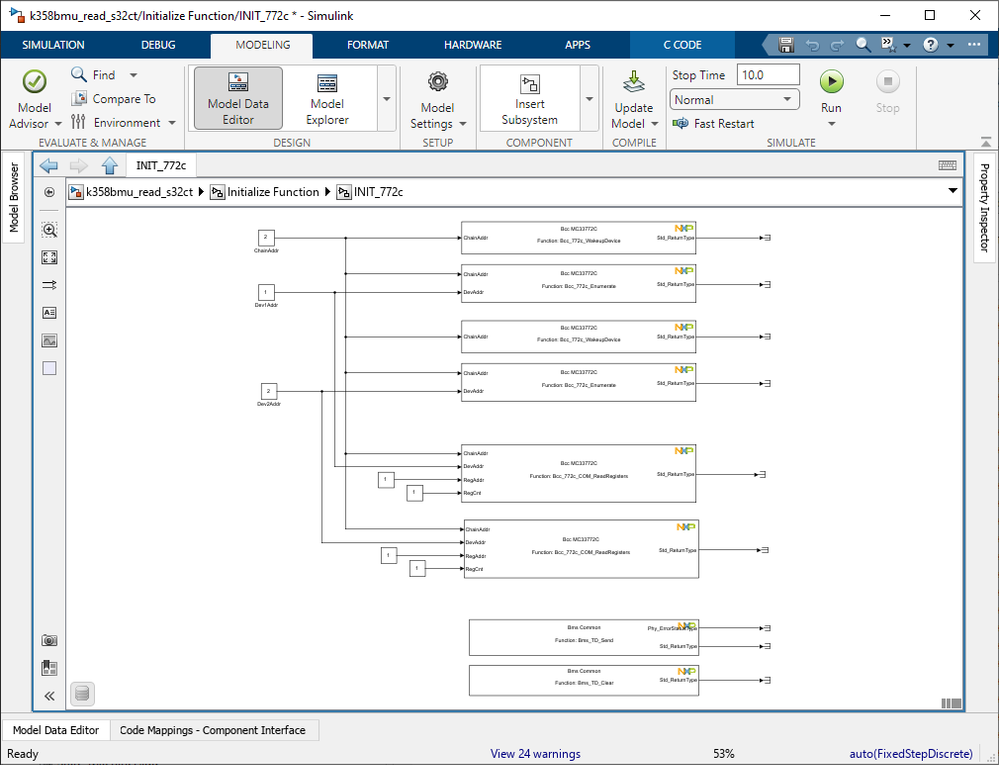

    2. The Initialization of each BCC device - on the BJB there are 2 BCCx772C which works together for the redundancy. In order to work properly, they need to be enumerated, so that they receive each an BCC ID. This process can be commented in the Initialize Function, the INIT_772C.mariuslucianand_1-1732120190614.pngmariuslucianand_1-1732120190614.png
