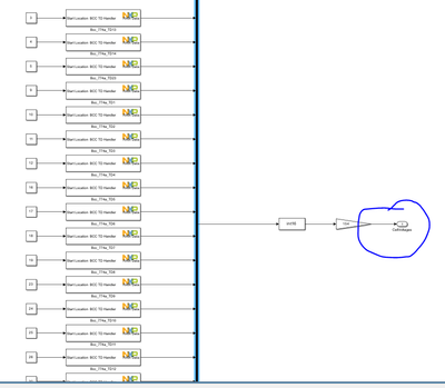

I am using HVBMS 800V reference design from NXP. I tried to read the voltages , calculate min and max values and then publish on CAN .However, I see the voltages are always fluctuating . When I tried to find the root cause, I see that the NXP which sends the values from the below block is actually varying. Also we are using demo model shared by NXP . Kindly help how this fluctuation can be reduced. We see that on emulator , we set 2.7 for all sliders .However, i see voltage from 0 to 5V fluctuating or oscillating.
Note : We are using 18cell emulator with HVBMS800SCT KIT.
3,070件の閲覧回数
ShivaB
@mariuslucianan Please help on this if possible ...we are using reference model by Nxp but when we are calculating min and max values for cell array voltages and transmitting the data over CAN, I see voltages are fluctuating. I am setting all voltages as 2.7 in 18 cell emulator but see them varying from 0 to 5V
