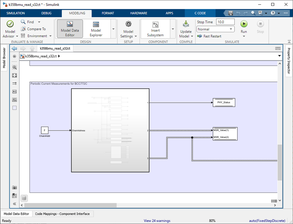

    3.  The periodic Current measurements, which starts the global conversion and each step time it reads the measured BCC analog values. Also needs to be commented when no BJB is used. mariuslucianand_2-1732120239920.pngmariuslucianand_2-1732120239920.png

Of course the application will show errors and timeouts when you are not connecting the BJB, but the CMU part shall work as expected.
