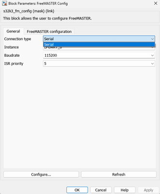

Is there a CAN connection in Freemaster for the S32K344 MBDT toolbox?
If there is how I use can. If anyone knows can you help me?

Hello @Baris ,
Unfortunately, the S32K3 toolbox does not include support for FreeMASTER over CAN, hence only the Serial option is available in the Connection type dropdown of the configuration block. If further information on how to use the FreeMASTER functionality inside MBDT for S32K3 is required, please let us know about the issues you are encountering.

Are there any updates coming in that will support calibration in FreeMaster over CAN for S32K344

Hello @SSH23
We can't provide an exact time frame of when FreeMASTER over CAN will be available inside MBDT for S32K3, yet this is a feature we are currently looking into. We will keep you updated on the availability of this functionality.
