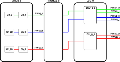

I'm working in Setting the base development environment for a DC/DC power converter.
This converter will be based on a interleave topology and them we need to control 3 half bridges basically working at 120º phase shift.
I’m using 1.4.0 MBD toolbox version with the R2022B matlab release.
I’m also using the NXP Configuration tool instead of the Tresos one.
As we need to keep in control the Phase shift we would like to work with the eMios channels configured in the OPWMCB mode. The idea is to implement the following scheme.

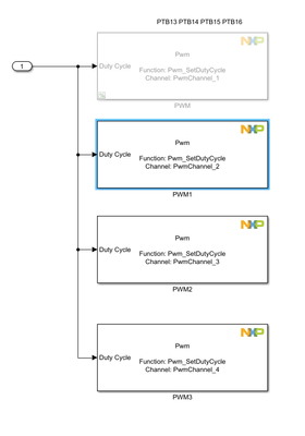

  2. The second problem arise with the PWM_SetDutyCycle function.  I’ trying to update de Duty with the following scheme (copy form the example).
The problem is that for the first of the channels updated, the Duty Cycle is no updated and its output is frozen to its default value (The one configured in the config tool). This happens always with the first channel that is written in the model. As you can see, I first wrote to the channel 1 and detect the problem in this channel. Then I configure a 4th channel to see is there was a problem with the number of configured channels, and everything works in the same way (channel 1 frozen to its default value and the three other channels changing its DutyCycle). The last test was to comment the write to the first channel. In this scenario, the problem appears on the second channel instead of the first one.

The second problem is still there. The first pwm eMios channel is hook to its default value despite the generate code is writing to it the new value.
Now I will procced to export the code to DS and procced to debug it.
