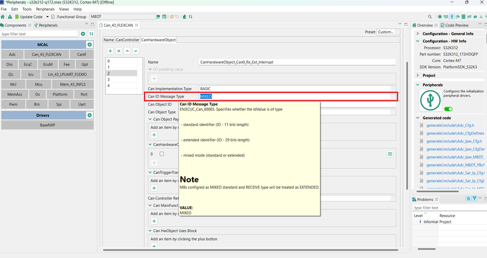

paul_14
Hi @Irina_Costachescu
Yes, I already had this CAN Hw Object with message type as MIXED.
I have all these CAN Objects:
0. CanHardwareObject_Can0_Rx_FIFO: FULL/MIXED/RECEIVE
1. CanHardwareObject_Can0_Rx_Std_Polling: BASIC/MIXED/RECEIVE
2. CanHardwareObject_Can0_Rx_Ext_Interrupt: BASIC/MIXED/RECEIVE
3. CanHardwareObject_Can0_Tx_Polling: BASIC/MIXED/TRANSMIT
4. CanHardwareObject_Can0_Tx_Interrupt: BASIC/MIXED/TRANSMIT
And this is how my model looks like:

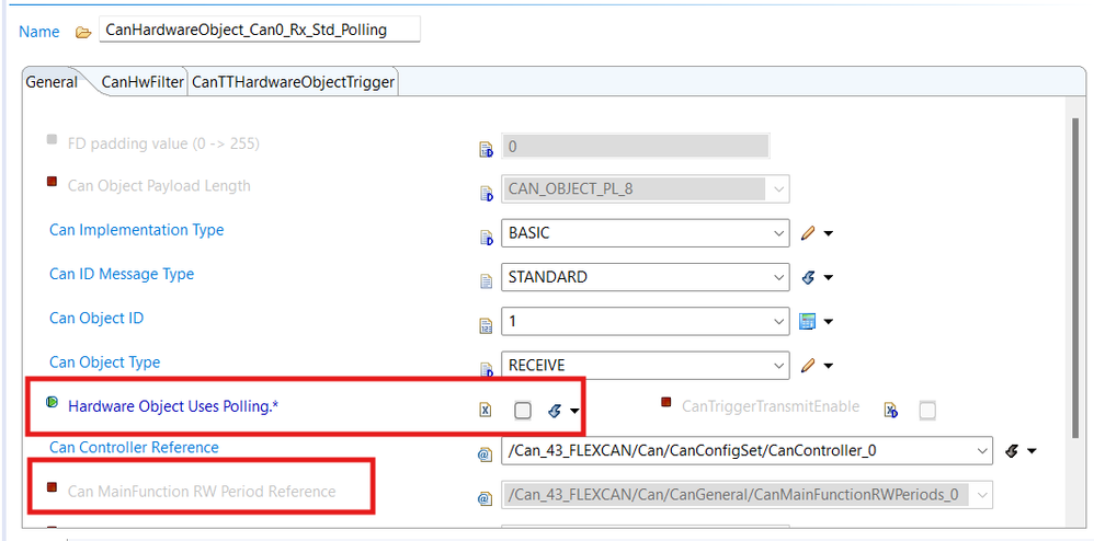

First of all, using the default configuration (no changes) that comes with the Toolbox for the S32K312-Q172, i managed to send both EXTENDED and STANDARD frames simply by checking and unchecking the "Extended ID Can Message" property inside the CAN_Write block. Additionally, I tried using the same Can Hardware Object (CanHardwareObject_Can0_Tx_Interrupt) to send EXTENDED and STANDARD frames on alternate execution steps.
Where I think I noticed a possible inconvenient was when trying to receive both STANDARD and EXTENDED frames, where it seemed like only the EXTENDED frames were being received. That happens because of the way the hardware objects are configured:
- CanHardwareObject_Can0_Rx_Ext_Interrupt is able to receive EXTENDED frames, and it's configured to work based on interrupts, meaning  there is nothing else you have to do in order for the message to be captured by the Hardware Interrupt Callback set to CanIf_RxIndication.
- CanHardwareObject_Can0_Rx_Std_Polling is able to receive STANDARD frames, and it's configured to work based on the polling mechanism, meaning that in order for this to trigger the Hardware Interrupt Callback, an additional block is needed, that being the Can Block set to Can_MainFunction_Read. This triggers the aforementioned Hardware Interrupt Callback when the hardware object set to polling is receiving messages.
Setting the Can ID Message Type to MIXED might not lead to the desired results when using the RECEIVE objects because MIXED is treated as EXTENDED for this case
I see the following options, to be able to RECEIVE both EXTENDED and STANDARD frames:
- use the configuration provided by default and also add a Can_MainFunction_Read block into your model, triggering the interrupt for the polling can hardware object
- modify the polling hardware object to work on interrupts instead:
Let me know if these explanations help you and if you manage to get the model to work as expected.

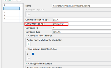

I looked at your model and I think I found a solution for your issue.
What I ultimately had to do was to set Can ID Message Type either to STANDARD or EXTENDED, for the RECEIVE objects. By keeping one of them as a polling hardware object, the MainFunction_Read is still necessary.
I chose STANDARD for CanHardwareObject_Can0_Rx_Std_Polling (id=1) and EXTENDED CanHardwareObject_Can0_Rx_Ext_Interrupt (id=2) (instead of MIXED).
With these changes alone I got the model to work in the following way:
- Sent EXTENDED frame from Can Analyzer - > started receiving EXTENDED frame messages with the ID incremented by 1 from the board
- Sent STANDARD frame from Can Analyzer - > started receiving EXTENDED frame messages with the ID incremented by 1 from the board
In case you are looking to also reply with the same message type, then you would need to implement a workflow that includes 2 Can_Write blocks (one with the checkbox for Extended enabled and one without), and based on the received frame, you redirect to the content to the appropriate Can_Write.
A few ideas on how you could differentiate between the frames:
- By received ID length, but this might be tricky depending on how this is stored
- By Hardware Object ID: going back to the configuration referenced above, CanHardwareObject with the ID 1 was set to receive STANDARD messages, so if your received CAN message comes from the object with the ID 1, you know it's a STANDARD message; otherwise if it's ID 2, then you know it was captured by the can hardware object with ID 2, configured to receive EXTENDED frames.
Please let me know if this fixes the issue you were encountering.
Robert V
