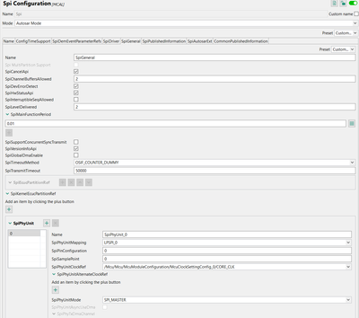

I have configured LPSPI0 as Master to use with a Slave.

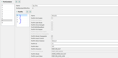

Pins
Peripherals
Port - configured with no issues

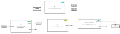

Model: Reused example model SPI Asynchronous Interrupt Transfer S32CT, modified so that an LED Blinks after a successful job instead.

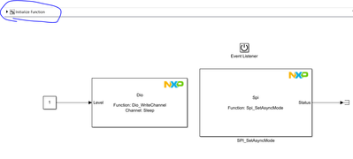

This is what's inside the Initialize Block
There were issues building the model with regards to Lpspi_Ip_LPSPI_1_IRQHandler and Lpspi_Ip_LPSPI_2_IRQHandler.
I disabled those interrupts and enabled for LPSPI0 in S32CT - Platform component

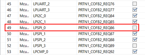

Following an initial review of your .mex file, I noticed that while the LPSPI interrupt configurations have been updated, the MCU tab still enables clocks for incorrect LPSPI instances. Please ensure that the clock is also enabled for the instance you intend to use — specifically, LPSPI0. You can find this setting at the following path: Mcu -> McuModuleConfiguration -> McuModeSettingConf -> McuPeripheral
I'll continue analyzing your file in more detail, but I recommend making this adjustment and testing again.
