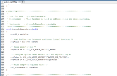

Is it possible to reset the uC within Simulink software? My idea is to have a CAN message that can reset the uC when the signal is set to '1'.

I see there is this function in system_S32K148.c
I am just not sure how to use it in my Simulink model as this is part of the generated folder after a build

Hello @Poley ,
Please see the example attached here https://community.nxp.com/t5/NXP-Model-Based-Design-Tools/Can-you-read-the-uC-s-serial-number-in-cod...
Hope this helps,
