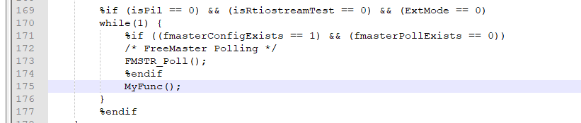

I wonder how can you allocate a task or function to run in the background loop using NXP MBD toolbox on Matlab/Simulink? Can this functionality be added?

I want the function to run on the infinite while loop. I am aiming for something like this:
int main()
      while(1) {
      MyFunction();
Is it possible?

the only way in which this can be done, is to open the mbdtargetmainlibs32k.tlc attached in the toolbox, look inside that file and add your function name in the following location. Then insert your function with custom code.
