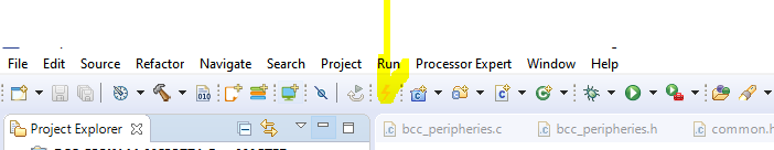

2. Flash from file:
  • In the icons menu just under Run press the Flash from file buttonpastedImage_3.png
  • Select the new imported project, Browse for the generated .elf/.mot from the Simulink folder, Make sure that in the Build the Debug_FLASH is selected and check the DIsable autobuild option.
  • In the next tab, Debugger select the OpenSDA as Interface and check to see in the Port that the tool recognizes the Open SDA on the board. If you need a full Erase, please select the Emergency Kinetis Device Recovery by Full Chip Erase.pastedImage_7.png

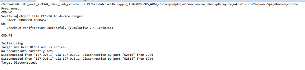

  • Next tab, Startup should look like this, so now you can press the Flash button.pastedImage_8.png
  • The board will be flashed and you will get a similar output:pastedImage_9.png
