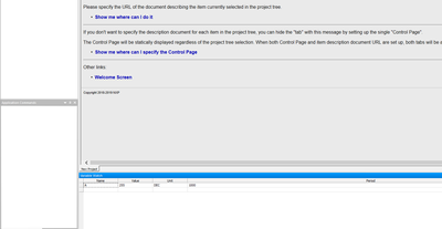

But when I try to observe the variables via Freemaster tool I received an error and after that the LED just above the openSDA port is constantly turned on to red LED and it is still on. After that I try to built different examples but I received same error each time and the red LED is on after the boards is powered. I guess that Freemaster can not find to board because it is in some kind of error mode.
I attach model, error, and board screenshots. What is the root cause of this problem and how can I solve it. Please let me know if further details are needed.

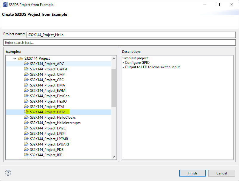

1. Import project:
  •  Go to File -> New -> S32DS project from Example.
  •  Look after a project for your board, like S32K144_Project_Hello

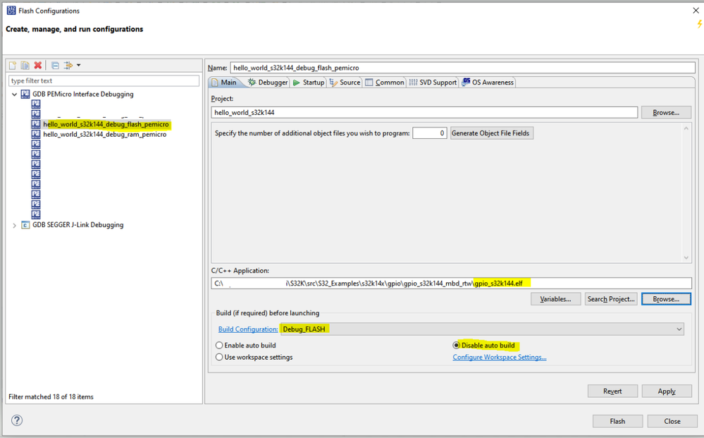

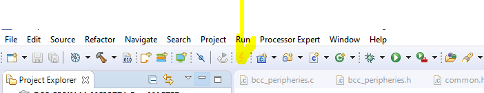

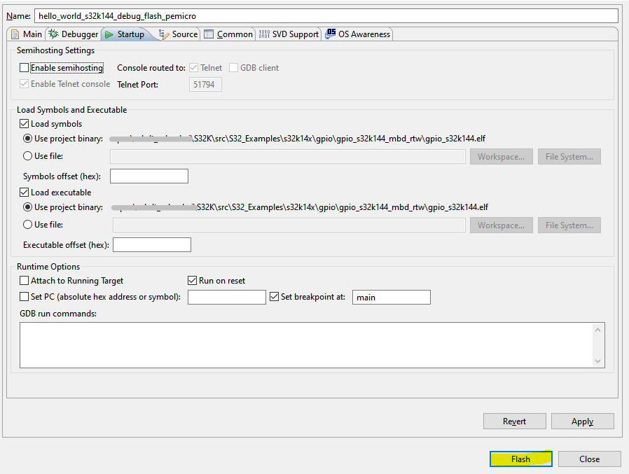

2. Flash from file:
  • In the icons menu just under Run press the Flash from file buttonpastedImage_3.png
  • Select the new imported project, Browse for the generated .elf/.mot from the Simulink folder, Make sure that in the Build the Debug_FLASH is selected and check the DIsable autobuild option.

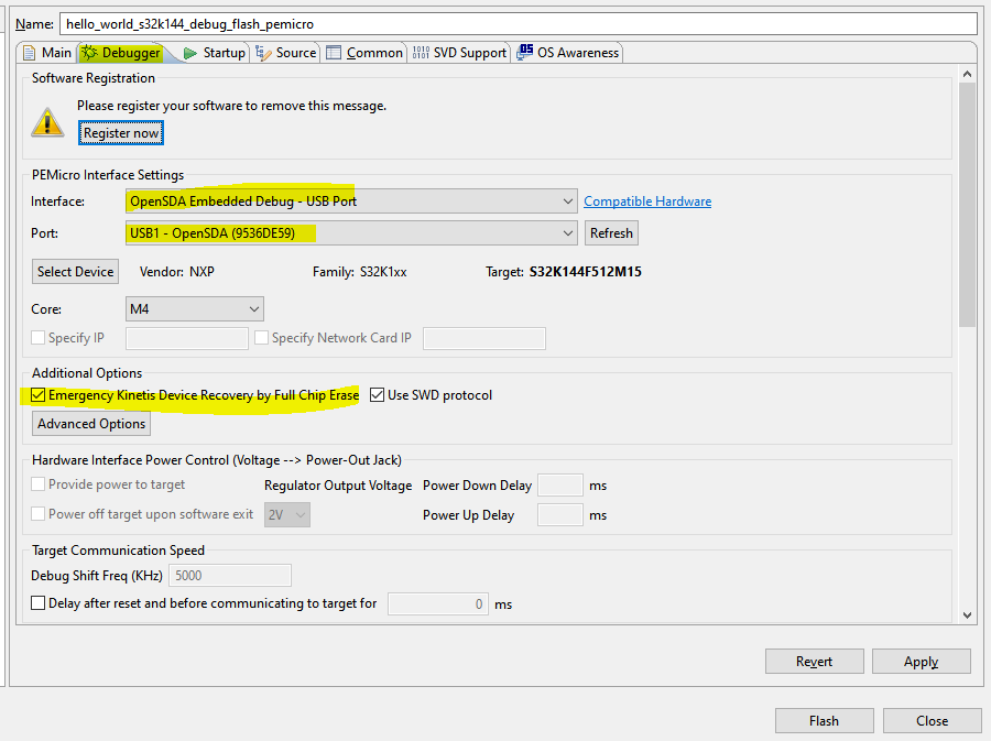

  • In the next tab, Debugger select the OpenSDA as Interface and check to see in the Port that the tool recognizes the Open SDA on the board. If you need a full Erase, please select the Emergency Kinetis Device Recovery by Full Chip Erase.pastedImage_7.png

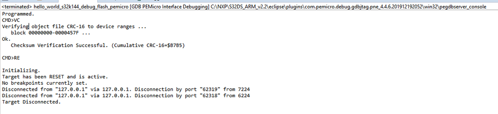

  • Next tab, Startup should look like this, so now you can press the Flash button.pastedImage_8.png
  • The board will be flashed and you will get a similar output:pastedImage_9.png

Thanks a lot, I followed the steps and the problem is solved, now I can upload the models directly from Simulink. I could not understand the problem completely but I understand that the problem is related with EEPROM.
The problem started when I try to write some data to permanent (non volatile) memory and this is a critical point for my project. If it is not possible with the following blocks, how can I write any data permanently (i.e S32K144 should store the data even the power is off and I should read the data after power turned on)? Are there any way to write data to non volatile memory and which blocks should I used in order to perform this task?
