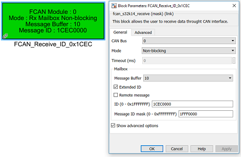

Hello everyone,
I'm trying to configure CAN RX with Model-Base S32K144 to receive CAN Ext ID 0x1CECXXXX.
I did the configuration for masking as the picture follows:
So I could receive all IDs that starts with 0x1CEC, but when I debug the model I can see it only accepts 0x1CEC0000, and for example not 0x1CECA232.
Is the masking configuration right? Could someone give me some hints?

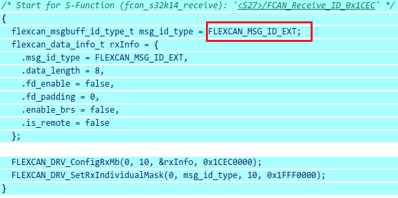

constantinrazva
Hello again [email protected]‌,
I have found the culprit - the global Rx mask was set by default 0xFFFFFFFF; so even after setting the individual Rx mask of the MB you wanted to use to 0xFFFF0000, the global mask still overwrites it - after changing this mask, your use-case worked on my end.
Later edit: The problem is with MCR[IRMQ] - individual rx masking and queue enable bit. This controlls if individual rx masking and queue features are enabled or disabled. I have updated the file attached by calling FLEXCAN_DRV_SetRxMaskType function to set Rx masking to individual.
Please find attached here the tlc-file you need to update:
{ROOT_DIR}\mbdtbx_s32k14x\mbdtbx_s32k14x\blocks\fcan\fcan_s32k14_receive.tlc
Please confirm that everything works on your end too.
Thank you for posting this bug with details - that was helpful!

vinicius_olivei
Now it complies and flash.
I can see the difference in the code:
But, the issue is the same, if I send 0x1CEC1234 for example it does not recognize it, sending 0x1CEC0000 the global RX_DATA variable is updated.
I have 4 global variables that update its value when any CAN message is received (ID, DATA, LENGTH and TIMESTAMP) and I check this with FREEMaster.

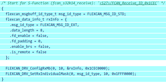

vinicius_olivei
Thank you for the fast response Razvan.
This is how the code looks like:
6,950 Views
constantinrazva
Hello [email protected]‌,
I have come to the same conclusion and I made the changes necessary. Please replace the following file with the one attached here:
Could you confirm that with this fix everything is working?
