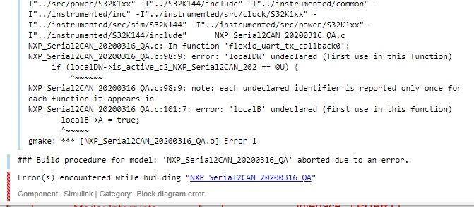

I am making a Serial-to-CAN Convert module using NXP S32K144 EVB.
Thanks to Razvan's answer, my previous problem was clearly solved by using LPUART for Serial Rx and FlexIO UART for Serial Tx.
There is no error when Running a model. However, another error was found while building a model as below,
For your reference, I will attach my Simulink model.
Thank you.
From Kim.

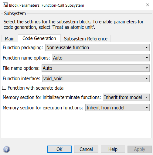

Hello [email protected],
Sorry, I must have missed the attachment. The fix for your model is simple - do this for Function-Call Subsystem and Function-Call Subsystem2:
- right click on each of them
- click on Block parameters
- go to the Code generation tab
- select Nonreusable function as Function packaging
You should now have your model working.
Note: I have updated the FlexIO patch on your other thread (here) - added a change to the configuration block as well [even if the model was building successfully, the application would not have ran the desired ISR for flexIO; now that is fixed as well].

kmun61a
Hello!! Razvan,
Your answer is PERFECT!!
Thank you so much!!
