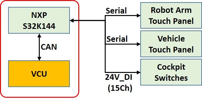

I am making Serial-to-CAN convert module using NXP S32K144 evaluation kit.
System configuration is as below,
(There are two serial communications and 15 digital Inputs in my Serial-to-CAN convert module.)
The Serial-to-CAN convert module transmits and receives 32bytes data between S32K144 and Touch Panel as below,

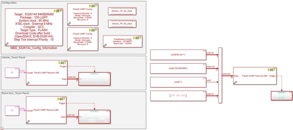

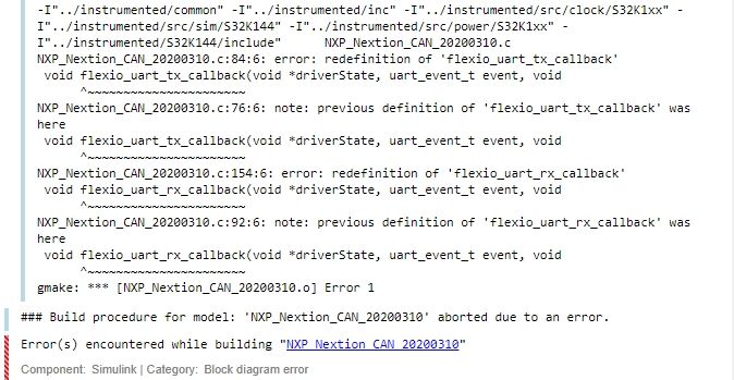

However, the problem is when I use two touch panels as below,

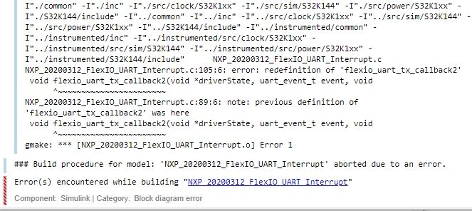

When I just Run above program, there is no error. However, when I try to build the program, an error happens as below,
Please, help me out!!
Thank you very much.

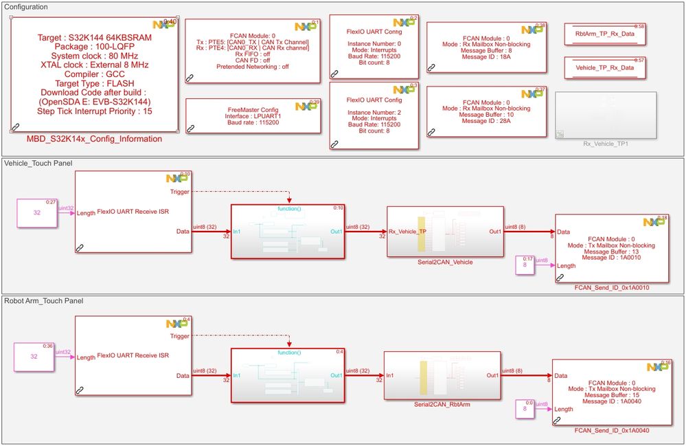

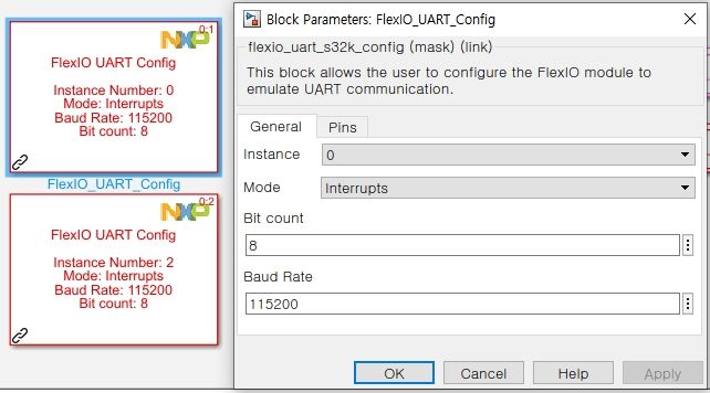

For your reference, I set the FlexIO UART blocks as below,
Instance is set to 0 in case of vehicle touch panel. Instance is set to 2 in case of Robot Arm touch panel.

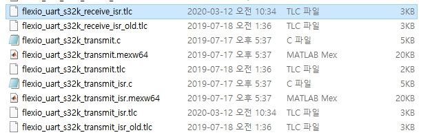

constantinrazva
Hello [email protected],
Could you replace the following files I have provided in the .zip attached here?
{TOOLBOX_ROOT}\mbdtbx_s32k\blocks\flexio_uart\flexio_uart_s32k_receive_isr.tlc
{TOOLBOX_ROOT}\mbdtbx_s32k\blocks\flexio_uart\flexio_uart_s32k_transmit_isr.tlc
[added] {TOOLBOX_ROOT}\mbdtbx_s32k\blocks\flexio_uart\flexio_uart_s32k_config.tlc
You can just rename the existing files by adding something like _old at their name and then copy these new files.
Please let me know if you're still facing issues with your model.
Kind regards,
Razvan.
edit: Also added changes to the config block (last file).

kmun61a
Perfectly cleared!!

constantinrazva
[email protected],
Please note that I have updated the zip by adding 1 other file that has changed - flexio_uart_s32k_config.tlc.
Even if the model was successfully building, the application would have not executed the ISR you expected for flexIO UART - now that is also fixed.

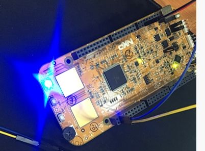

Build error was not happened any more. However, I guess serial communication (rx data) is not connected between NXP and touch panel.
Because, there is no change in the FreeMASTER.
In addition, if NXP receives the data from touch panel, the Interrupt happens and the Blue LED should be blinked.
However, the Blue LED turns on, which means that the interrupt is not occurred.

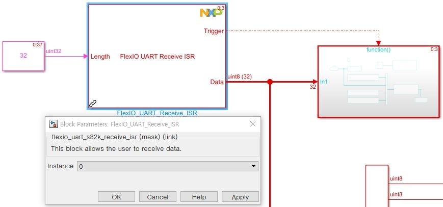

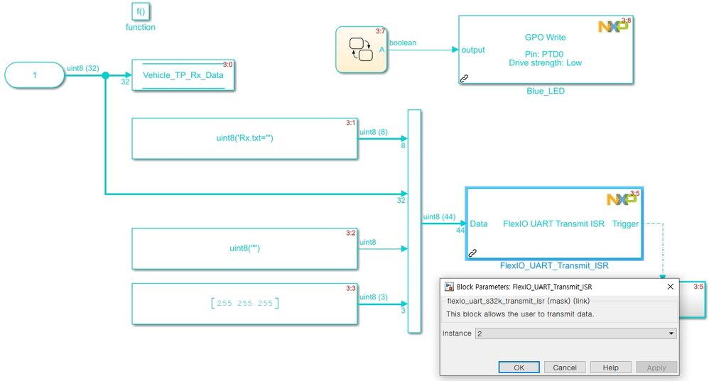

And then, I tried another test.
I put the "FlexIO UART Transmit ISR block" inside function call block to outside as below (also as attached Simulink file)
A Build error is happened again as below,
I am looking forward to your answer.
Mr. Hyoil Kim.
