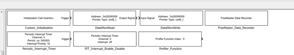

I am using S32K144 MBD tool. Now I want to use Free Master Block. However I find that there is no 'Free master configuration' in the lib now.
There is just one "Free Master Data Recorder". Did anyone come across the same problem?

Sorry. I think I got the answer -- the new version put the conf in this block:
The video is old version of MBD.

Hi Meiqi hu,
Starting with MBDT v3.0.0 (https://community.nxp.com/docs/DOC-335555 ) we have enhanced and moved the FreeMASTER configuration block outside the S32K14x configuration. Based on your screenshot you are using the older version 2.0.0 of the toolbox. Perhaps you can upgrade to the newest version 3.0.0 in order to be in sync with the videos.
