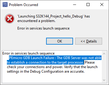

raywu
Ok I think I see the problem now. I assigned PTA4 as input, which is also SWD_DIO.
I tried flashing from S32 design studio but I'm getting a connection error.
I found someone that did something similar but on a Freedom board. Bricking and Recovering FRDM-KL25Z Boards: Reset, SWD Clock and Low Power | MCU on Eclipse
I tried the recovery utility he linked, but looks like an external programmer is needed. I was unable to interrupt the S32K over OpenSDA. Do you see any other way to interrupt the S32K?
For future reference should PTA4 and PTC4 on the EVB be avoided? I'm also seeing some tutorial about pin muxing in S32 design studio. Is there a block to set that up in Simulink?

raywu
Right, so to clarify, PTA4 and PTC4 on the EVB be avoided if I'm planning on using OpenSDA?
6,627 Views
constantinrazva
Hello [email protected],
Yes, that would be correct. What do you want to use those pins for? We can help you out re-routing if you want.
Kind regards,
Razvan.
