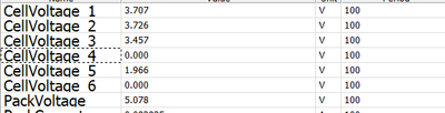

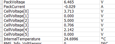

I have been working with MC33772B for 2-3 months now for testing BMS algorithms. I ran into a few problems now, the voltage reading at the pins and battery cells doesn't match with the Freemaster reading.
I have checked the FreeMaster variable settings and everything looks fine. I also monitored raw values and it looks like raw values are incorrect.
Below is the voltage reading for 6 cells.
Here are the raw values for 6 cell voltages and status
The actual pack voltage is 17V and individual cells have approx 3V but the raw value of 6 here is 0.
Also, I have noticed that the values start updating very slow after the microcontroller is reset. Even the pack voltage goes up to 13-14V (which is still not correct as the actual voltage even at the board is 17V). The same setup was working correctly previously. However, I replaced the S32k144EVB now as my old one is bricked and I am not able to fix it.
Here is the screenshot of voltage going up after 5-8 mins: Still the values read for cell 1 and cell 2 are incorrect. The other cell voltages are close to actual.
Can someone help me debug where the problem is?
Thanks!

parveez
@mariuslucianand
I wanted to mention this weird behaviour in voltage measurement. I am getting correct voltage measurement after I leave the setup and Freemaster running for about 5 mins. What I mean to say here is after approx 5 mins the voltages(cell and Pack) increase and reach to actual values.
But if I reset the mcu, the voltages drop back to low and start increasing and takes 5 mins to reach tot heir actual value. However, the multimeter reading at pins X1 on board is always read correctly.
Here is the screenshot after 5 mins of starting the measurement.
Here is the screenshot after mcu is reset without making any changes to SW/HW/cells/board: Just pressing reset on MCU S32k144
I am not understanding why this behaviour is. I have done this multiple times while using previous MCU and never came across the behaviour in measurement.
