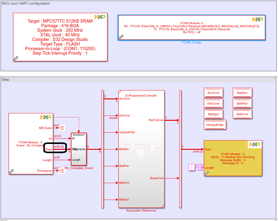

I'm building an interface for a controller that has 7 inputs.. The FCAN Rx block seems hard-coded to output a uint8(8), a vector of uint8 integers of size 8.  Is there a way to override the length?  And the type?  For example, if we need uint16 instead of unit8 to represent the inputs?  Or two uint8 bytes to represent each value?  The MBDT only includes examples with type uint8 and vector size 8. It is not clear from the examples if other sizes and types are possible, and if so, how. Thanks

Note that the size of the FCAN Tx block input is different, uint8(3), in response to input Length=2, showing the size of Data can change for the Tx block.

Based on what I have learned since posting my original question, I ***suspect*** the MBDT does not yet support CAN FD, only CAN 2.0A/B (ISO 11898) which is limited to one 8-byte block. CAN FD supports 64 bytes per frame but that seems to require coding in C using S32DS.
