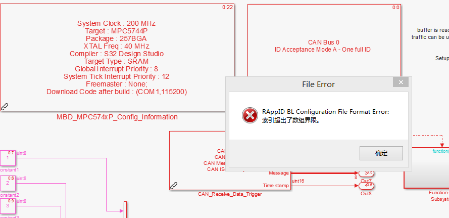

RAppID BL Configuration File Format Error

Hello Daniel,
as you said, use the default path, it works, Thank you~
But during the protyping progress, it exists another problem, do you know why~

Hi [email protected]‌,
The RAppID BL is the tool that loads the application into the MCU FLASH or SRAM memory.
It requires a special piece of SW to run from MCU flash memory prior of being able load the application generated from MATLAB/Simulink
Have you flashed the RBF (special sw) into the MPC5744P Flash memory ?
If so, then let us try a simple test. Take the *.mot file from the ***_rtw folder and program it with the RAppID_BL.exe from ...\mbdtbx_MPC574xP\tools\BootLoader location.
Does it works ?

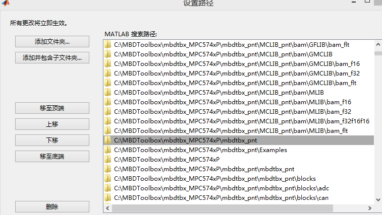

zhangjing711
Hello Daniel.
what a pity, it doesn't works.
My Matalb is installed in Disk D, MBDT is installed in Disk C, does it matter? A little bit strange~Thank you~
4,710 Views
Daniel_Popa
Can you check the MATLAB paths ? Do you see the the mbdtbx_MPC574xP added (especially the folder highlighted) ?
What happens if you open one of the mdl files from the Examples folder? Are you able to see the NXP blocks?
Thank you!
4,710 Views
zhangjing711
Hello Daniel,
Yes, I checked, I saw this path. Open one .mdl from the example folder, I can see the NXP blocks. Thank you~error9.png
