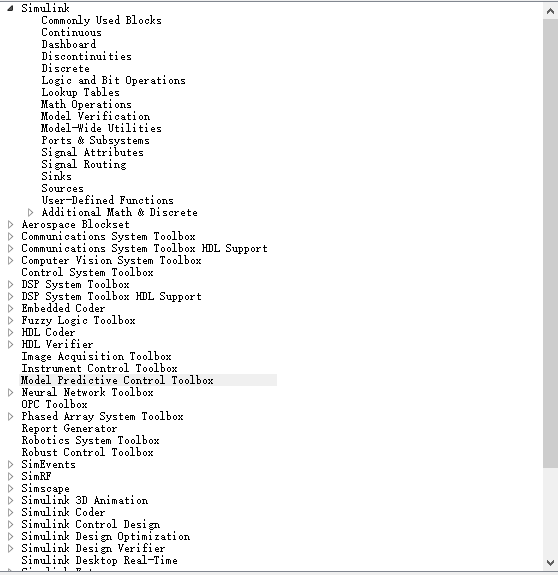

OK,uuuuuuu, the develop board for MPC5744P is still on the way~This problem could be for further trial.
But still a problem, I open the Simulink Library, don't find the Model Based design ..... for MPC5744P library. So could you do me a favor~Thank you~
3,897 次查看
Daniel_Popa
Hi zhangjing711@126.com‌,
After you run the mbd_pnt_path.m file, the MPC5744P Simulink library blocks should appear in the Simulink Library. If you still not able to see it after executin the mbd_pnt_path.m then please fit F5 (refresh) in the Simulink Library Browser.
Hope this helps!
3,897 次查看

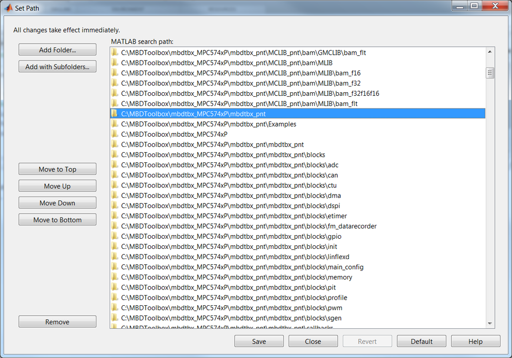

Daniel_Popa
Can you check the MATLAB paths ? Do you see the the mbdtbx_MPC574xP added (especially the folder highlighted) ?
What happens if you open one of the mdl files from the Examples folder? Are you able to see the NXP blocks?
Thank you!
3,897 次查看
zhangjing711
Hello Daniel,
Yes, I checked, I saw this path. Open one .mdl from the example folder, I can see the NXP blocks. Thank you~error9.png
