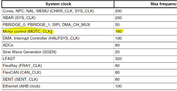

haoxue1027
Contributor V
Hello,Marius
I am a liitle confused to the MOT_CLK, here is 160 max frequency.pastedImage_1.png
How to configure the MOT_CLK to 80Mhz?
best regards
hao
4,177 Views
mariuslucianand
Hello [email protected]‌,
The clock for the MPC5744P has already been set to 80 MHz. The eTimer, CTU, FlexPWM use the MOTC_CLOCK source which is aready set to 80.
MBDT does not provide a block to change the clocks (mainly because there are some restrictions related to peripherals requirements)so there is a bit more complicated process to do so. If you want to modify the clocks, please have a look not his thread Clock Configuration of MPC5744P using MBD . But you have to be very careful when doing that!
Hope this helps,
Marius
4,177 Views
haoxue1027
Contributor V
Hello,Marius
The clock for the MPC5744P in the MBD module  has already been set to 80 MHz.
So I cannot configurate it in the module, If I want to change it to any value else, I must modify the code.
I got it  , Thank you very much.
