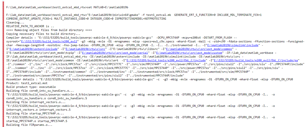

The CTU is configured to trigger the ADC conversions when the flexPWM reloads。
At the same time,I set the adc command interrupt to toggle the led.
but  it is failure due to an error. matlab ver:2019b,MBD ver:3.20;
Can you help me to solve it?

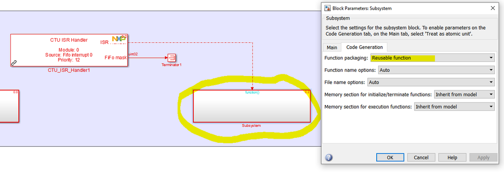

This looks like a compile error. The variable test1_extcal_IN_A1 has not been found in the CTU interrupt file. One of the way in which this can be solved is to right click of the s-function called by the CTU interrupt block, go to Block Parameters: Subsystem and select reusable function in the Code Generation tab.

Hello,Marius
I have set it as you commanded , and it worked. No errors happened.
Thank you so much for your assistance.
It helps a lot.
