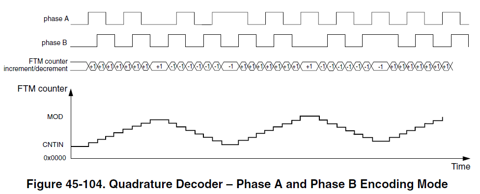

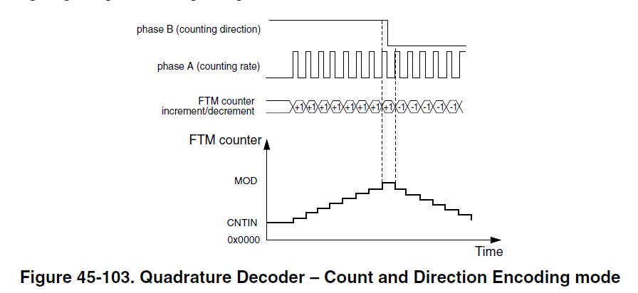

Quadrature Decoder – Count and Direction Encoding mode
In this mode, the phase B input value indicates the counting direction, and the phase A input defines the counting rate. The FTM counter is updated when there is a rising edge at phase A input signal.
Quadrature Decoder – Phase A and Phase B Encoding Mode
In this mode, the relationship between phase A and B signals indicates the counting direction, and phase A and B signals define the counting rate. The FTM counter is updated when there is an edge either at the phase A or phase B signals.
If you want to use the Count and direction Encoding Mode please also select this in the QD Mask, because in your example it looks like there is a bad setting.
