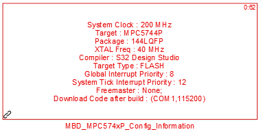

i have sometimes a problem with the Config_Information Block:
After a lot of compiling and flashing the device, there is a problem.
The diagnostic viewer says: Build error (see diagnostic.txt)
When i delete the Config_Information Block and put in a new Config Block, it works.
Thank you for help.
Lukas

Hi lukasschäfer‌,
I've not met this kind of situation in before.
Next time when this happens - can you delete the *_rtw automatic generated folder instead ?
I've a feeling that the root cause might be there instead of Simulink config block.
Keep us in the loop, and eventually try to send us the model when that issue occurs in order to try it on our side, hopefully to reproduce the error.
