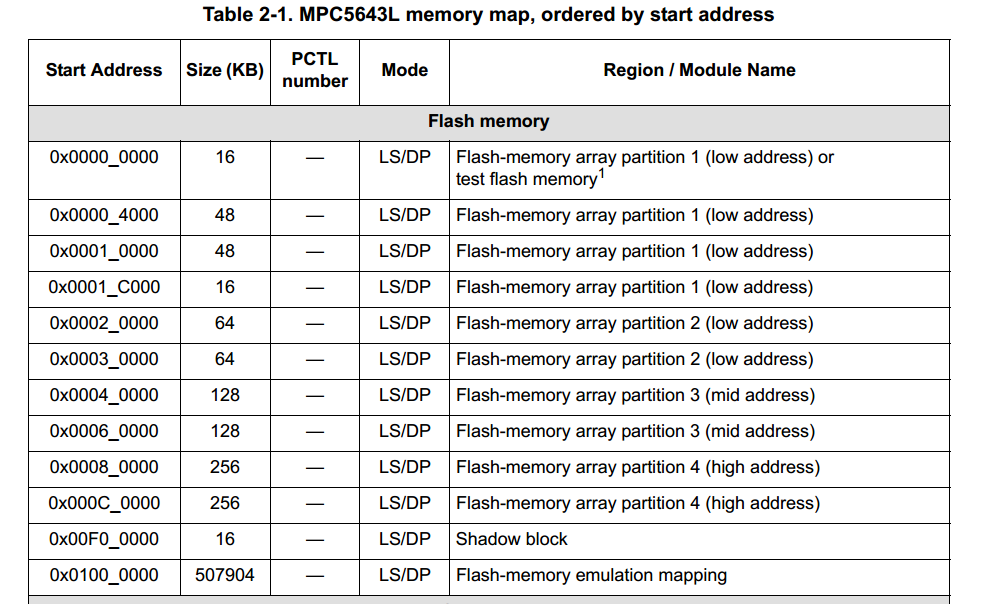

there is another question about the write address of the memory:
1#Can i configure the in the Calibration address in the ROM that is 0x0000 0000-0x2000 0000,that is right?
2#or i must configure the Calibration address in the the RAM?
5,132 Views
Daniel_Popa
Should be RAM address since after boot-up all data are copied into RAM.

As you said, Calibrate the Param  in the rom,if i wanna Calibrate the Param from flash(ROM),we must first map the ROM Address to the RAM?
and i built the simulink model shown as below:
the *.MAP file shown as below:
Why the the address of Calibiate1 is not 0X4000001C?
5,132 Views
Daniel_Popa
Hi edenli‌,
That is not how the DataMemBlock works. Check the generated code and you will see something like:
/* Memory Address Write */
/* Memory Address : Base Address + Offset */
/* Memory Address : 0x4000001C; */
uint32_T * (write_mem_address);
write_mem_address = (uint32_T *)0x4000001C;
*(write_mem_address) = ***Calibiate1;
The Calibiate1 and others are data variables and they will be placed in the data sections as any other variables in your program.
The DataMemBlock just take the value carried by the variable/input signal and write it in the memory location.
You will have to do the memory management by yourself - making sure you are not overwriting other stuffs.
Right now your program most likely will crash since your are writing an area that might contain useful data for the program.
