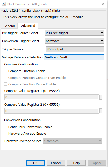

The ADC Config block.
A interesting point that I don't it helps is that when a change the conversion trigger select to Software, the program runs and I can connect to freemaster. Obviously the ADC reading does not work properly.

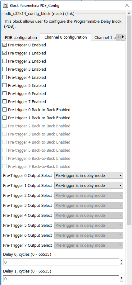

The PDB Block

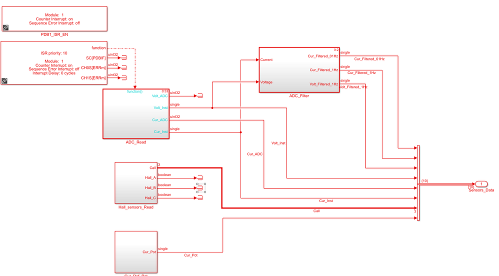

The Sensors Block

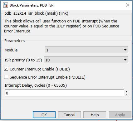

The PDB ISR Block

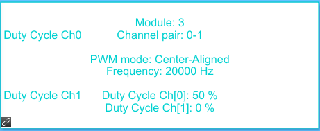

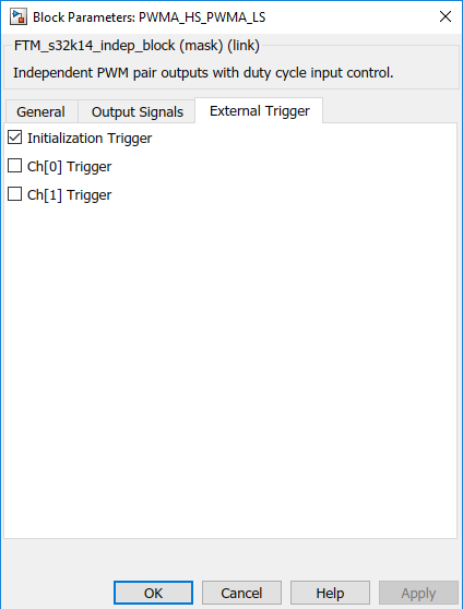

The PWM Block
